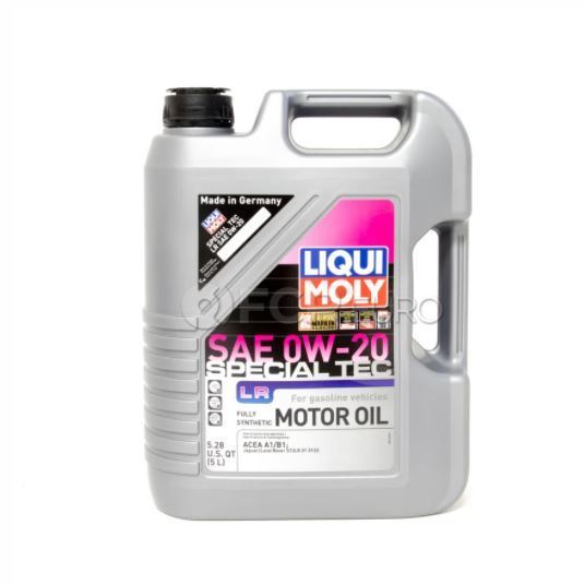

For the most part is everyone sticking with 0W-20? And if so, Castrol seems difficult to find but I have found LiquidMoly in that weight and I used LiquidMoly in my Porsche's for years. Would that suffice?

LiquidMoly is good, that is a Jag-spec oil if I'm not mistaken.

Yes...LiquiMoly has the Jag Spec approved oil. It appears to be very good oil, and reasonably priced.

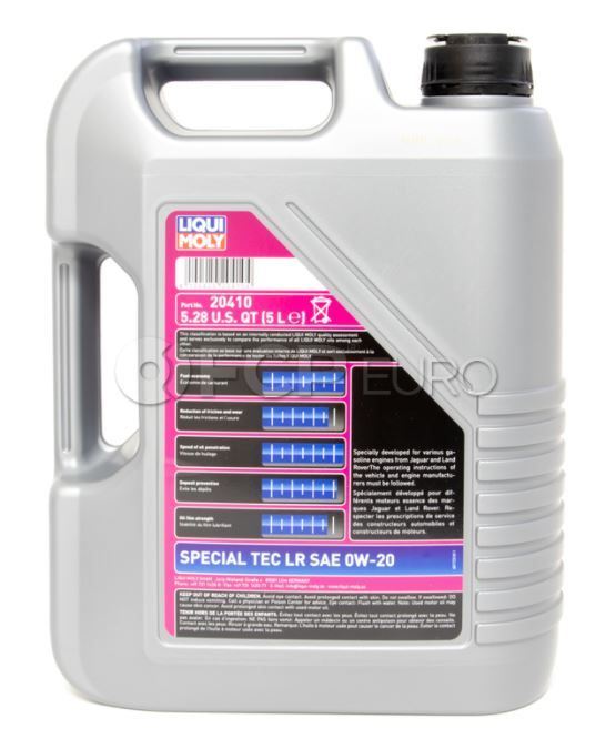

Isn't the current JLR specification for ILSAC GF6? The Liqui Moly Special Tec is GF5 as far as I could find.
CANCEL THIS:I see that both the Motul and the Liqui Moly meet the Jaguar Land Rover specification 51.5122. Both seem easier to find than the dealer-only Castrol Edge Professional 0w20.
