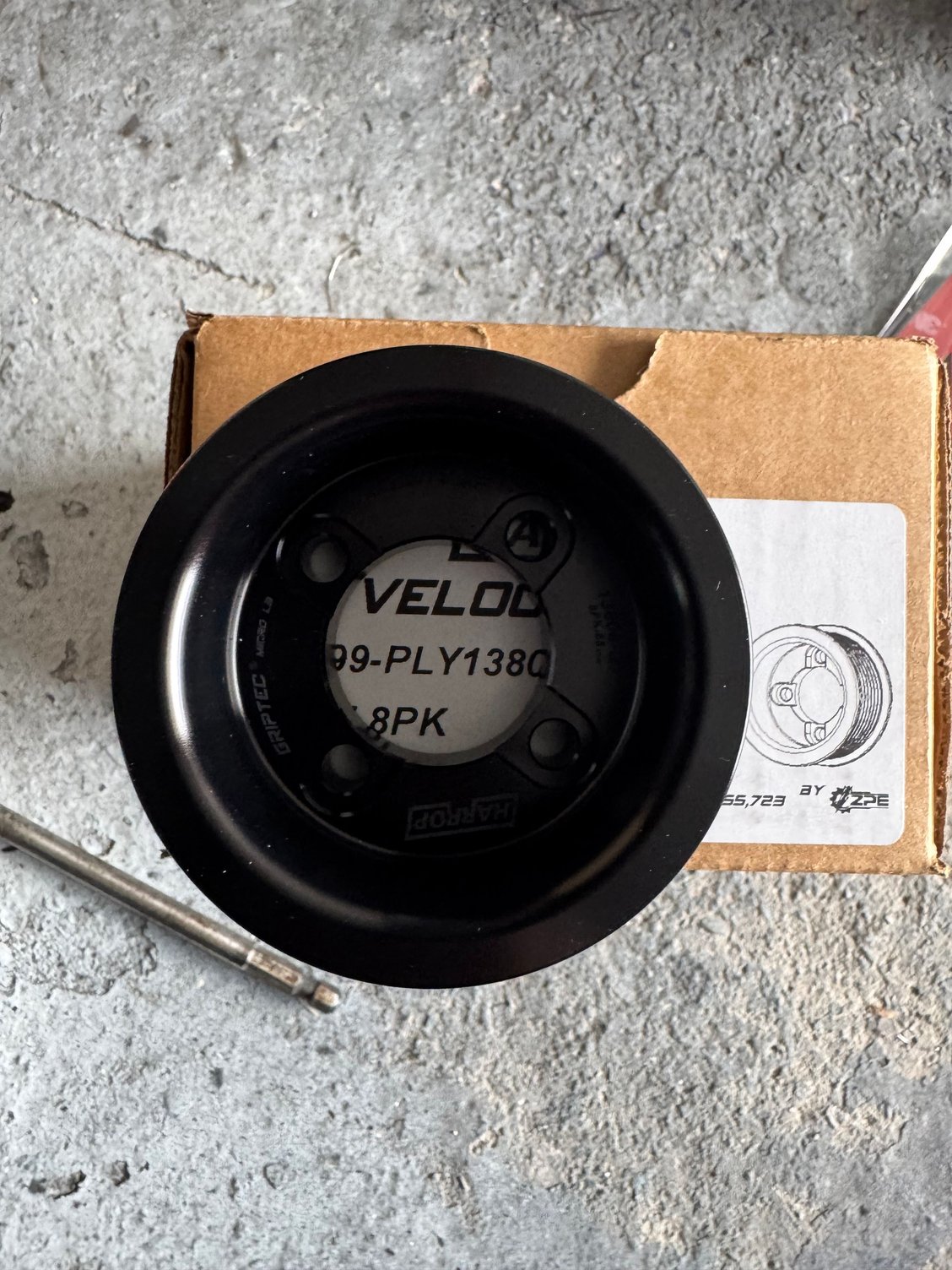

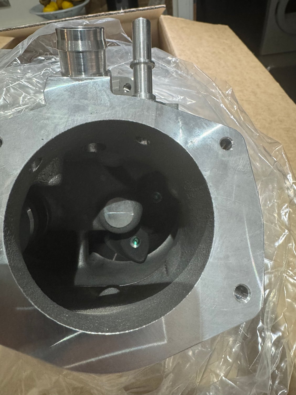

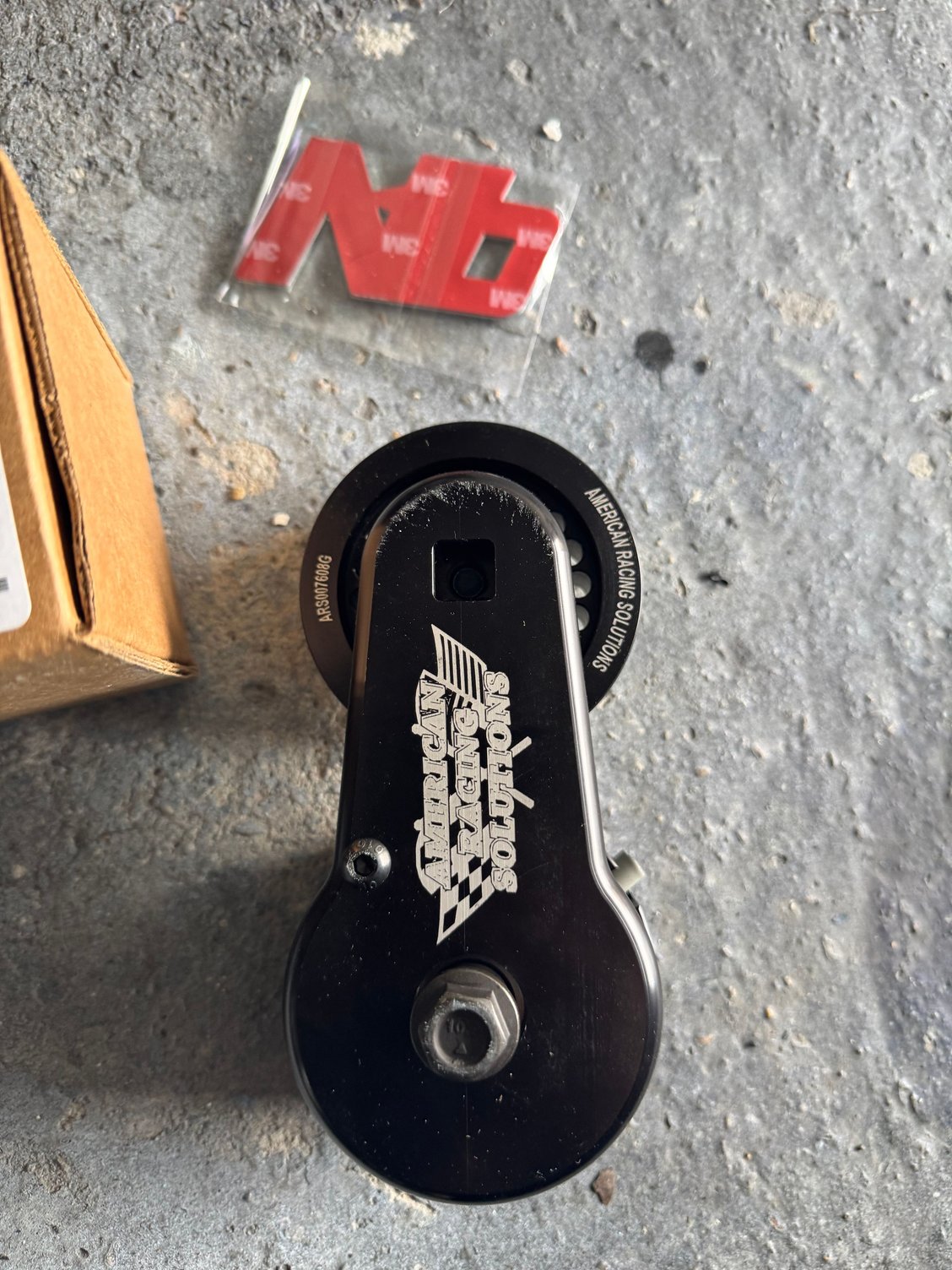

Just waiting on my velocity ap tvs2300 supercharger and tensioner
already have the vap upper and lower pulley

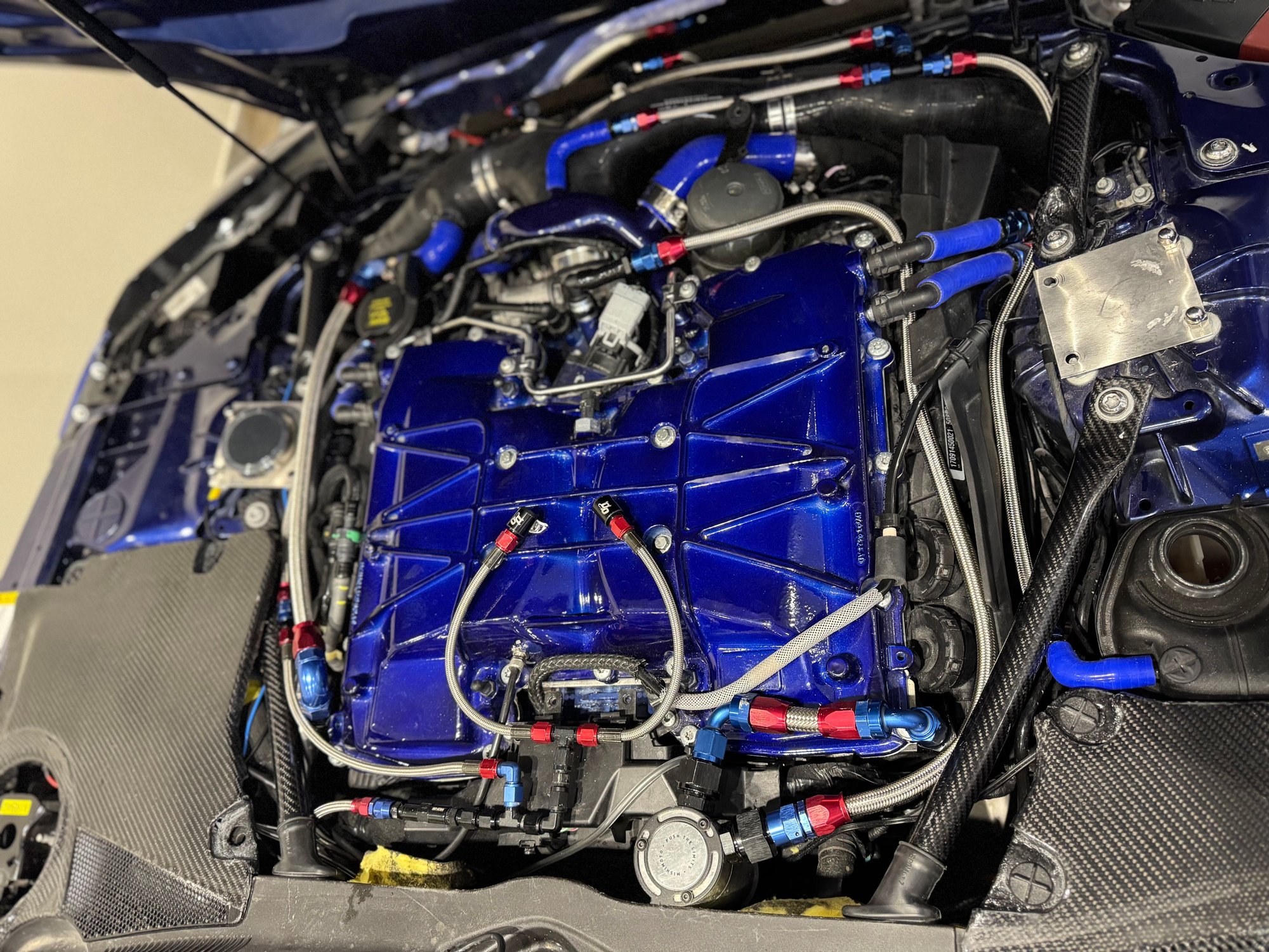

i am not an expert but I think cooling is the key to this upgrade as Vap stipulate Water meth injection
I already have my snow performance water meth with controller to have start and finish point for the injectors

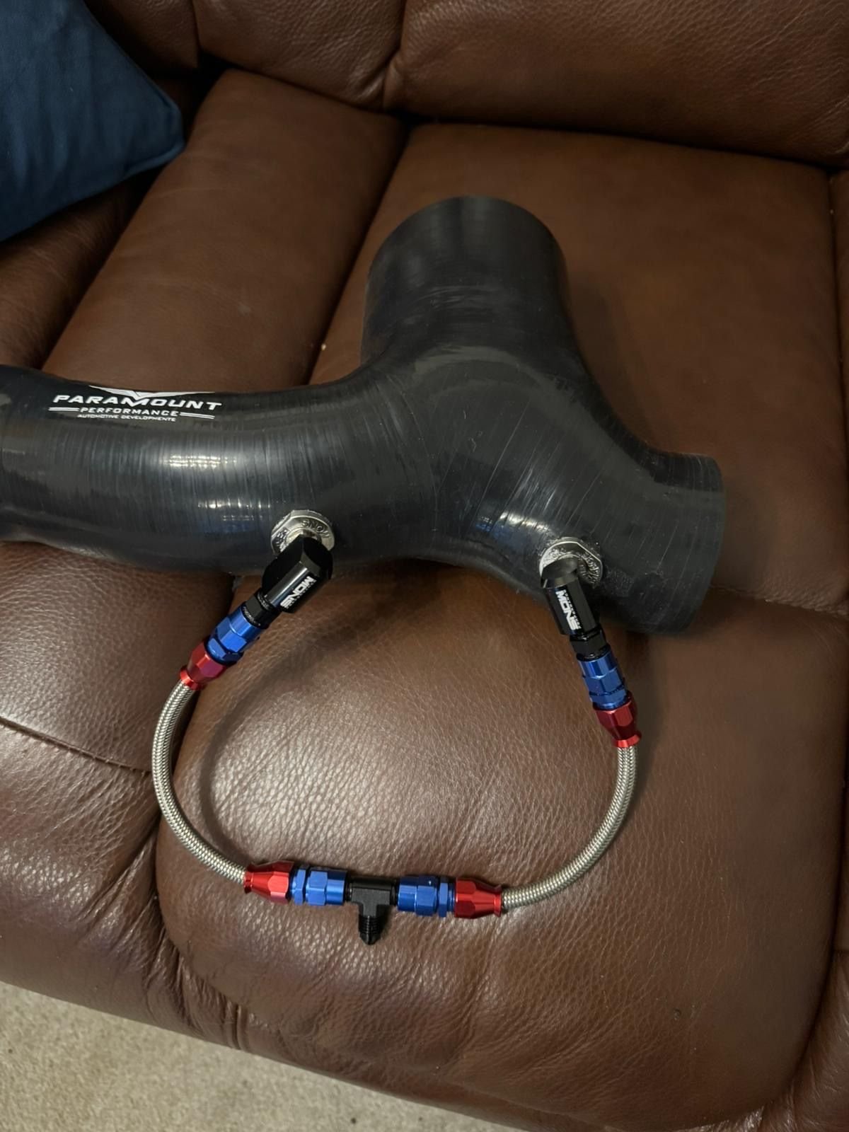

Vap uses 2 in the pre throttle body
i was already running 2 in my charger lid but Stuart advised a specific flow rate so have added 2 in the pre throttle body area

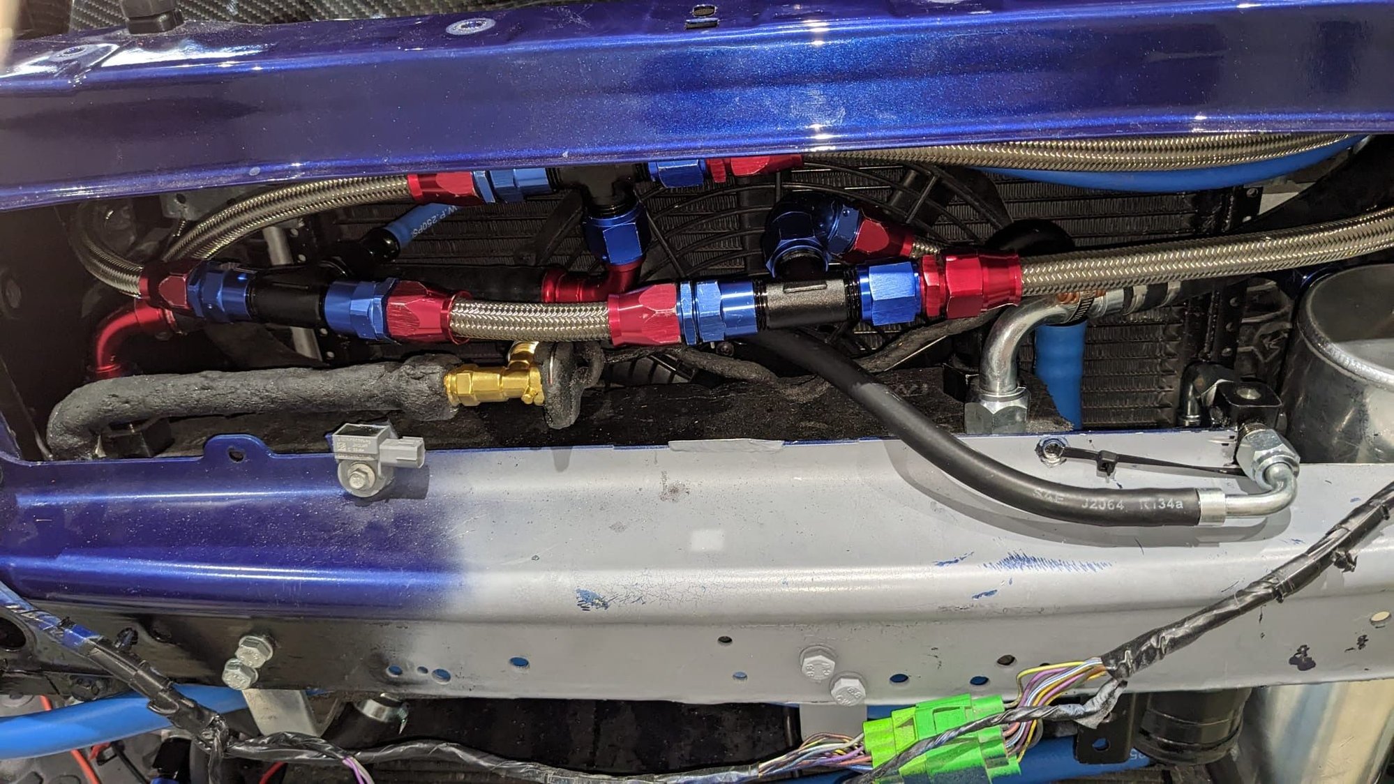

plus i am already running a stage 2 fi interchiller that has me running only a couple of degrees above ambient even when flooring it
Waiting on a fuelling module and electronic brake booster to finish the install

Hi yes the vap uses 2 injectors pre throttle body
i had already installed water meth before their kit came out and had put 2 in my charger lid
after talking to Stuart I decided to add 2 more

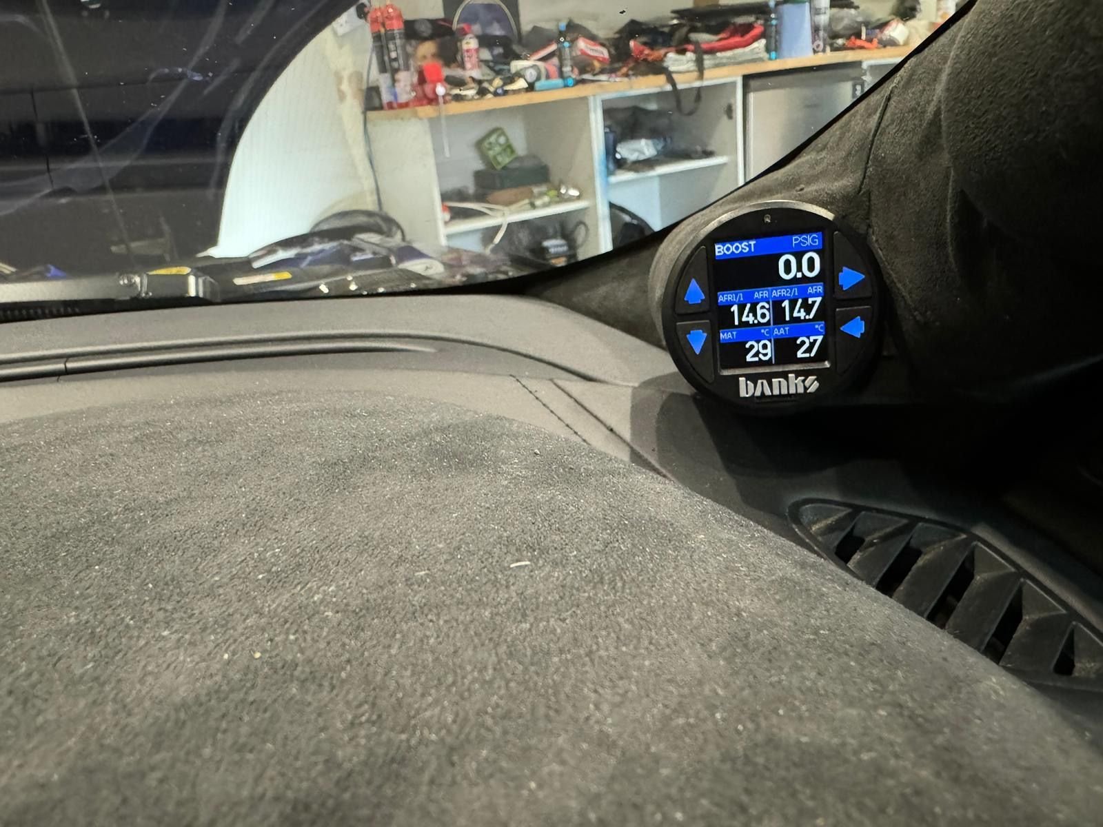

my iat and mat temps were already low as in barely above ambient and that was without water meth turned on
tbh I doubt there is another f type with temps as low as mine
as I said I have the stage 2 fi interchiller so could get lower still

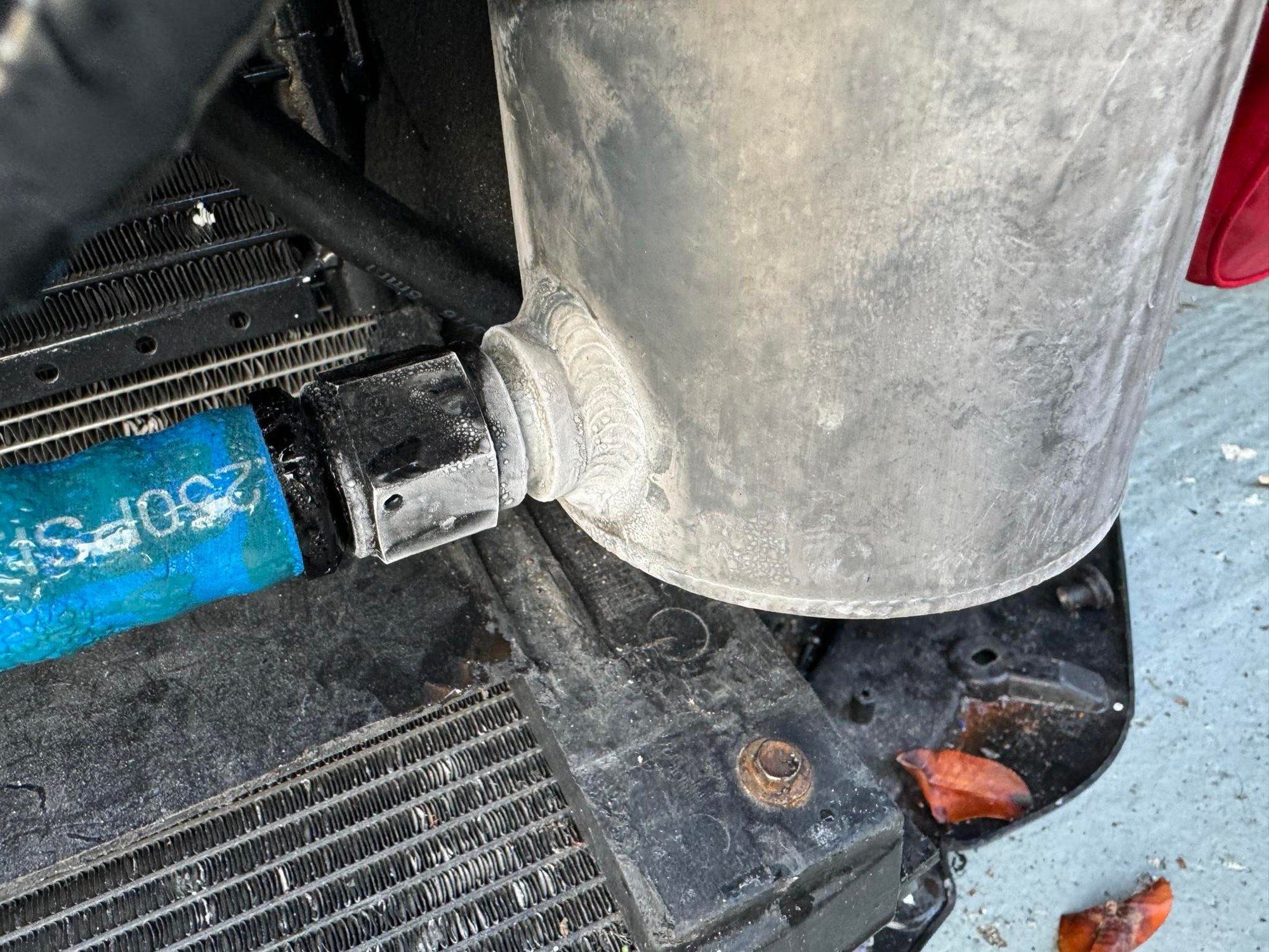

That’s ice on my reservoir for my supercharger coolers and I run a cwa400 pump to push it round via braided lines
i moved the lines out from the front of the engine to the front of the car

the fi interchiller is a revelation it keeps my intake and manifold temps hovering within a couple of degrees of ambient and that’s without the water meth running
water meth is fairly straightforward to install and control
the set point
The fi interchiller isn’t a straight fit but I can talk you through the necessary steps
i went for the stage 2 kit so can have cabin and chargecooler or just chargecooler
in terms of which is better I can’t say as both will do the job just in different ways so I did both lol

OMG this things intake is like the Mersey tunnel
the potential of this blower is shattering and imho at some point a built short block with pistons/rods/crank will be a must do
VAP have tested this blower for the last 12 months and I suspect had to dial down the boost
imo as a novice I would suspect engine internal would need doing as this mother can shift a ton of air
Just waiting on the Vap intake and fuel module and vacumm pump before fitting this all
