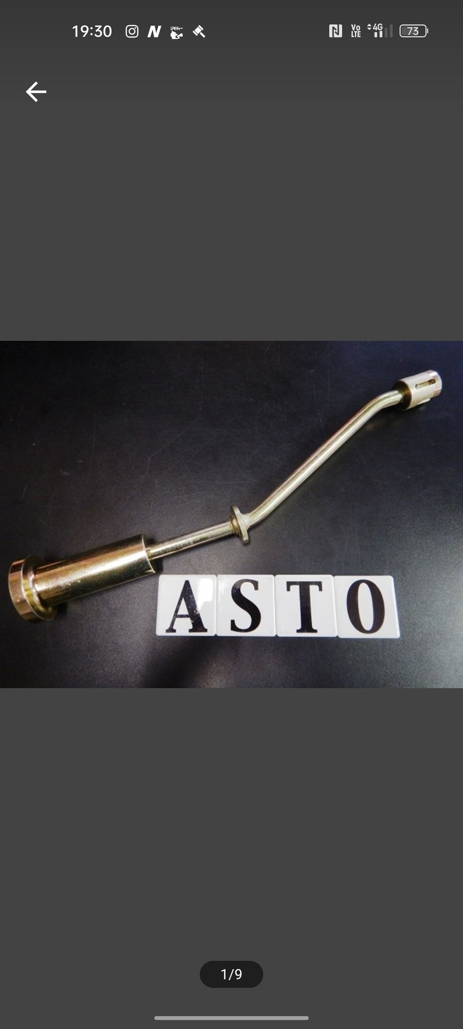

My Jaguar has 120,000 miles on it. The diagnostic tool showed that cylinders 4 and 5 were bad. Of course, the special tool didn't work. I used a large slide hammer, but it didn't work either. I haven't tried breaking the head and using an extractor yet, but I'm not sure if it will actually come off, so I don't have the courage to do it. Before that, I'm going to heat the injector with a burner, which is dangerous, and then use a slide hammer to remove it. I'll remove any fuel that's stuck on it. Why do injectors get stuck? Carbon clogged? Rust from water? Metal expansion from heat? At worst, can I get it out by drilling a hole?

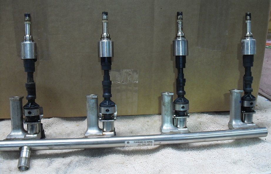

Here is how one side came out. Again all 4 came out with the rail by hand. Yes I was VERY lucky on that!
You can have several different problems that stick the injectors into the head. The tips with carbon from the combustion process and the large section that is sitting in the head. If water and junk get on top of the injectors that can get them stuck. I used brass brushes in the large and small bores after the injectors were removed. Just thought it was needed and had an experienced Jaguar tech suggest the brass brushes.
Note I was only able to remove them all at once because I had removed the engine mount nuts and used a board under the oil pan to jack the engine up and tilt it a bit for better access. This was the key for me. Otherwise it was just so tight.

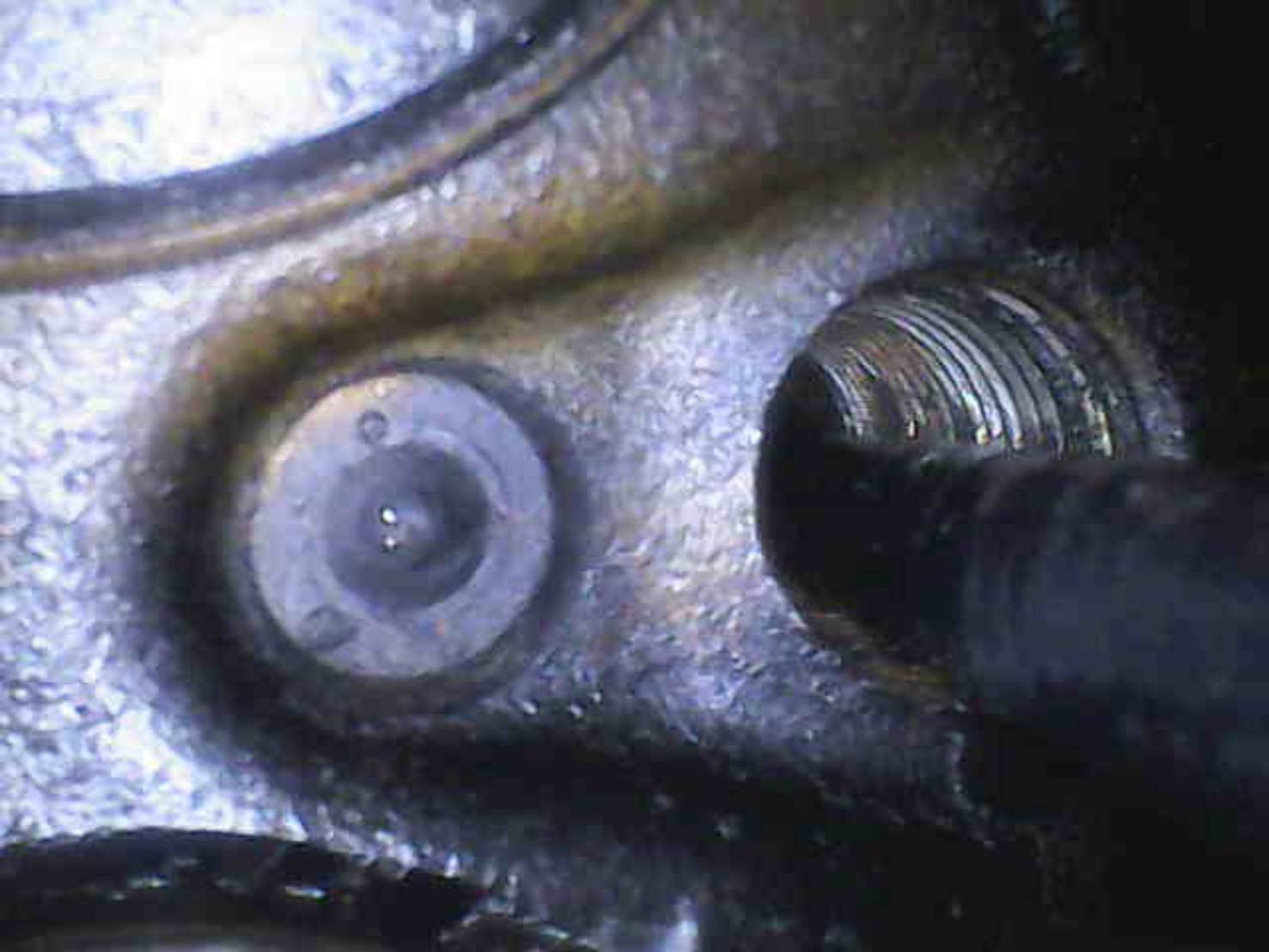

Thank you for your replies. I'm leaving the Frype alone because I still can't get the injectors out. I looked at the combustion chamber with an endoscope, but I didn't see any carbon buildup around the injectors.
