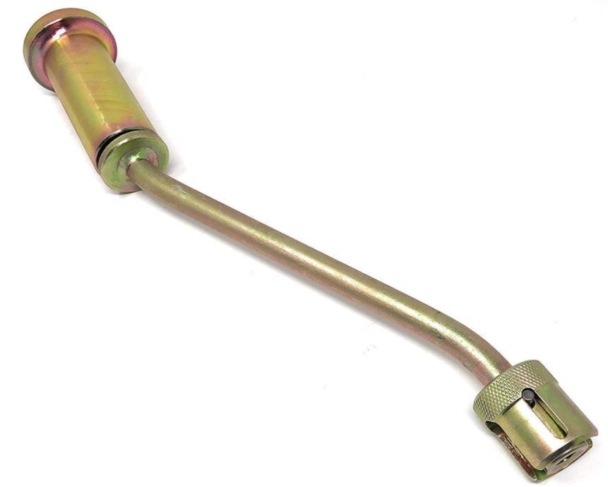

If you are skilled at auto repairs, you should be able to do it, but it is not simple or easy. The only tool you will need is the removal tool, which is a slide hammer type of tool that attaches to the top of the injector and yanks it out. Also, this is a GDI system, and the fuel rail/injection system is under extremely high pressure, so you need to relive that before opening it up...Make sure you do it correctly or it could cause damage or injury.
Also, there are a number of cases where the injectors become stuck/fused to the block, and in some cases, dealers have had trouble getting them out. Just FYI.
Again, it can be done, but you should be careful, follow proper procedures, and use the proper tool(s).
DC
The tool:

Having done this recently, here’s some extra tips that helped me.
- You need the special slide hammer to remove the injectors. The cheap gold colored ones on Amazon weren’t able to seal against the injector head, I purchased a second JLR injector remover that was gold with black clamps. Worked perfectly.
- If your injector is stuck, swap the hammer of the tool with something heavier. I used a 10lb exercise plate on my slide hammer and they came out with just a couple of pulls. Prior to this I had soaked the injectors in PB blaster multiple times over 2-3 days and had no luck. The extra weight from the plate worked right away.
