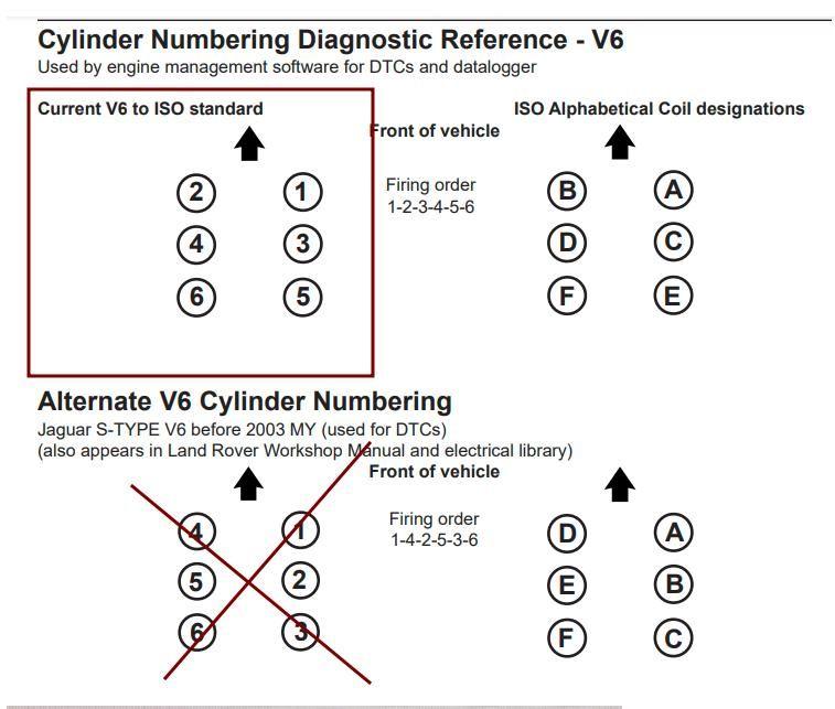

Thank you everyone. I just measured the compression of cylinder 4 and it was as shown in the video. It's at 10 bar so the compression may be fine. I tried swapping the plug with the one next to it but it didn't change anything. I also removed the coil and confirmed that it was making a crackling noise and replaced it with a new one but it didn't work. By the way, the diagnostic machine said that cylinder 4 was misfiring, but is the counting method in the image correct? It's a 2015 V6SC. On the autel diagnostic machine, it shows p0304 and p1315, but when I looked at the live monitor of the diagnostic machine, it was strange that the count number of the item [Combined Misfire Information Cylinder 6 Emission Misfire Count] was counted many times.
I feel like the way the diagnostic machine counts the cylinders is lying. Or maybe it's because the injectors are fake. There was no marking.

I don't think that cylinder numbering is correct. See this thread. There are a couple of diagrams midway down.

I saw the article and it seems like my cylinder count is correct.
Really? Maybe I am missing something here, but I don't see where what you have diagrammed in your picture is the same as the V6 here. Note, the one on the bottom left says it is for the Pre-2003 MY of an S-Type.
I have seen similar reference elsewhere as well. If you really wanted to know for sure, you could always just unplug the coil on each one at a time and watch realtime data to see which cylinder is misfiring.

you cylinder order is correct in post #9

I'll check the order again. I removed the coil for cylinder 4 in the #9 image, but the location of the misfire monitor didn't change. So I think it's cylinder 4. Is P0657 irrelevant? Where exactly is the fuel trim?

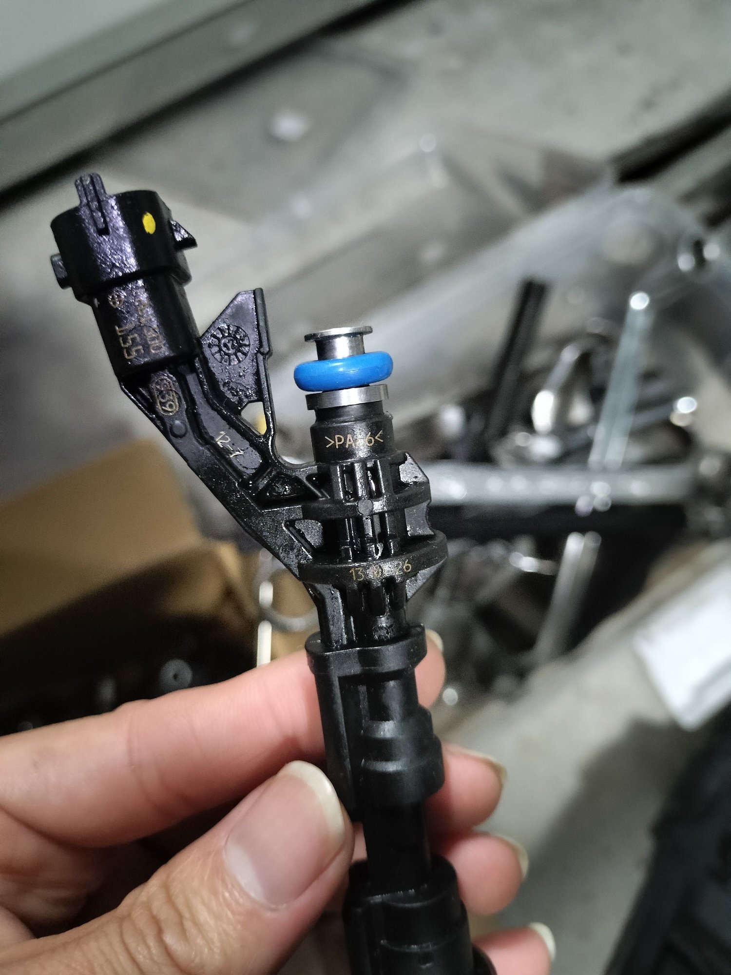

I checked the injectors and there was no marking on them. I replaced them with ones that did have the marking and the misfire stopped! Thank you so much. I appreciate it. Do those damn Chinese people have some grudge against Jaguar? There are only two other problems, P0117 water temperature circuit abnormality and the exhaust sound valve not responding when the switch is pressed. I replaced both water temperature sensors with new ones but it didn't work. Does anyone know what to do?

Correct that's what I told you up thread?
I had the exact same problems because of counterfeit injectors.
Throw them away unless you think you can get a refund from the seller?
It's all brands and all parts there is no targeting of Jaguar with these bad parts. It's a multi-trillion dollar world wide problem that effects almost every product in the world.

The correct injectors should have a white band and numbers along the plastic for future refrance

Don't forget the stylized Hella symbol too. I have a picture of this in my attached thread. Hella owns Bosch.
There are several clues if you look at the markings but they are close. They have copied the shipping boxes just about perfectly.
