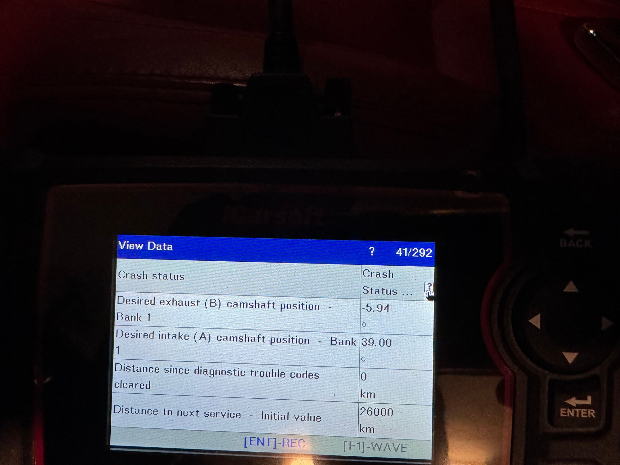

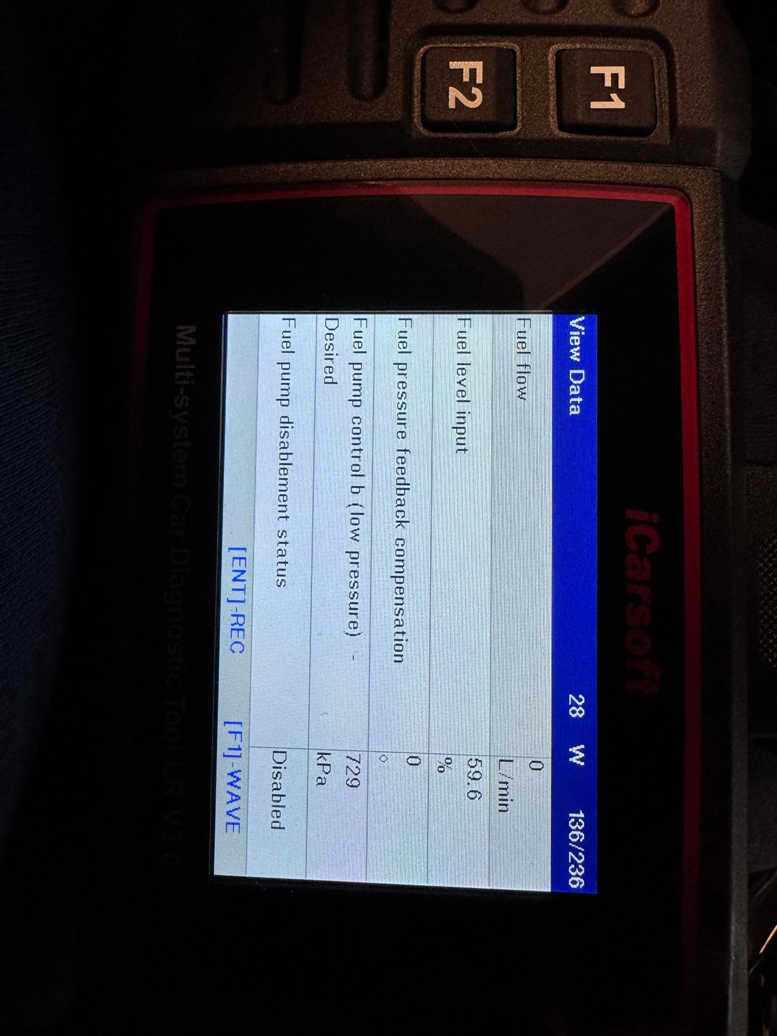

Hi Folks,
Hoping someone with an healthy F Type and an icarsoft can read a couple of codes on their car for me?
My car cranks starts and immediately stalls.
1. In the ECU, there is a data point called Fuel Pump Disablement Status: My car reads Disabled. I am trying to determine what a working car says.
2. Also in the ECU there is a data point called Crash Status. What does a working car say?
Thanks.

I checked and in my 2019 AJ126 I don't seem to have the "Fuel pump disablement status" option, and the "Crash status" leads nowhere - just starts a timer that doesn't seem to end.

Never - but entering the "Crash status" data module leads nowhere. Just a timer that doesn't end. Can you check yours?

@shashi27 Can you get into "Fuel pump disablement status" and set it from "Disabled to "Enabled"?
Not. It would not allow me.
