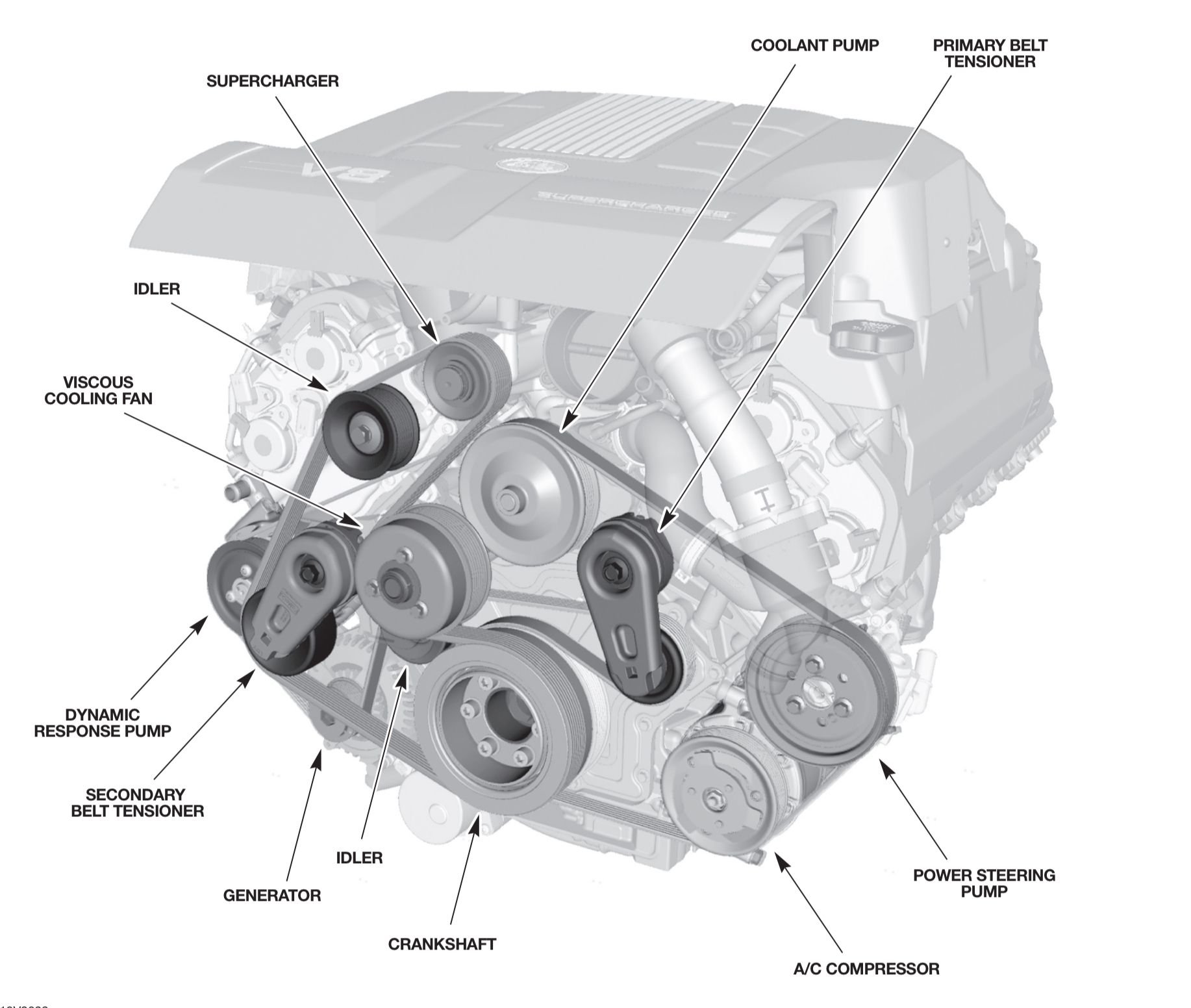

Theoretically, can I run the car without the SC belt and then also without the driveline belt to rule out the pulleys and accessories?
Old Feb 9, 2025 | 03:43 PM
DJS's Avatar
DJS
Posts: 7,027
Likes: 2,694
From: Metrowest Boston
It will run without the SC belt.
Is anything on the accessory drive belt other than water pump, alternator and AC compressor? Should run, but I wouldn’t do it for long.
Edit: power steering pump too…
From https://www.dropbox.com/scl/fi/y28ug...=sx2u8yqg&dl=0
