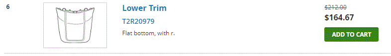

See below image - I need this part. Mine looks like ****. Flat bottom wheel, black.

Found this part number for 2014-2017 Flat Bottom, but it says "w/R". Do not see any without R? You can start here...
DC
Found this too. Check link....
https://parts.jaguarlandroverclassic.../brand/jaguar/
Old Jul 23, 2020 | 03:50 AM
Guardian's Avatar
Joined: Dec 2019
Posts: 172
Likes: 58
From: KrK
On the back of non-R-badged I found only this number: 6254491

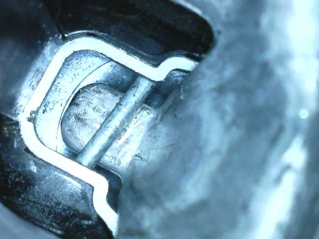

Here is a photo of the attachment location of the airbag as seen through the access hole on the back of the steering wheel via Bluetooth camera. In the picture The round wire, needs to be moved to the left past the tab. The wire is attached to the airbag, the tab is attached to the steering wheel. A small screwdriver is needed and the camera helps to see in real time.

Also, like SS4PK said, if you are planning to do this, do yourself a favor and a buy a cheap Bluetooth borescope camera. I would probably still be trying to undo the airbag clips if I wasn't able to see what I'm doing.
