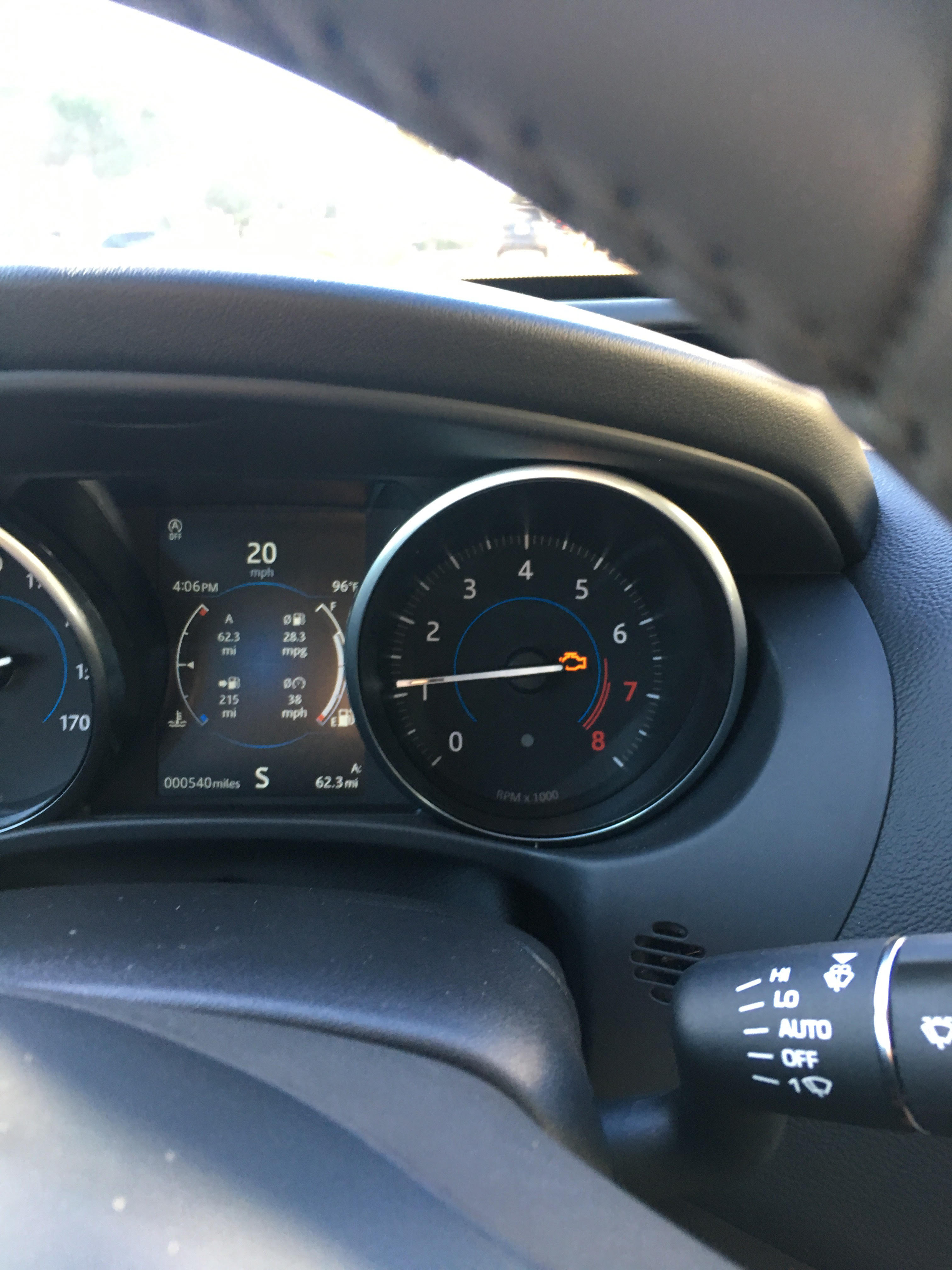

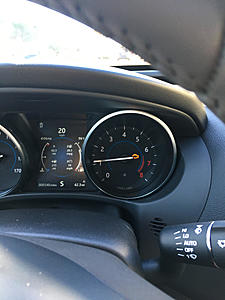

So, this is my loaner now...WTF?
Attached Thumbnails MASSIVE Failure. Loss of Power. Error Messages-jaguarxe_loaner_cel.jpg
