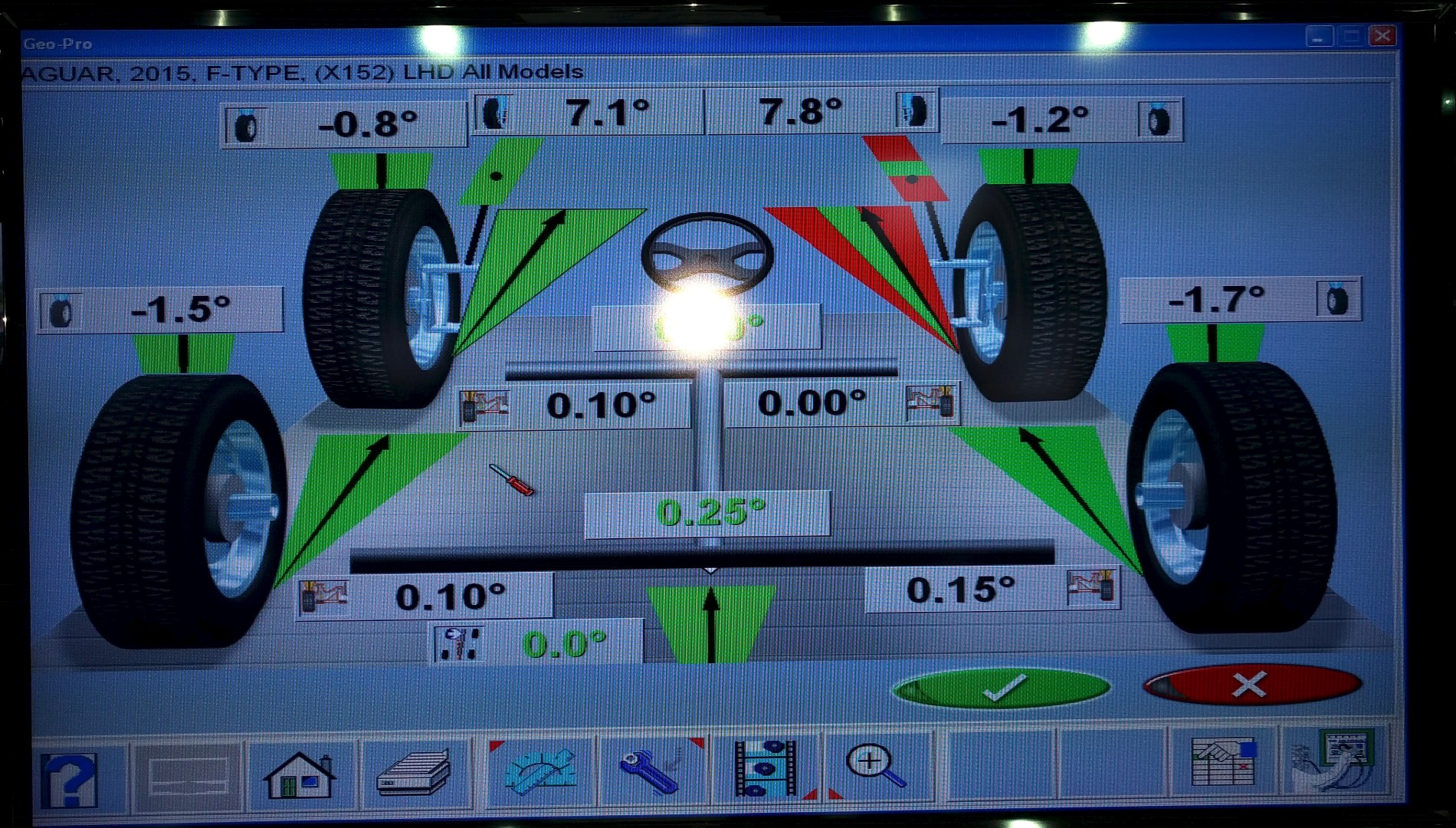

I had the alignment done today post Pilot 4S install. The numbers prior to alignment were way off. The shop owner said that he sees this allot with new cars. Hopefully the alignment will help make the tires last longer than 9800 miles for the old P-Zero. See alignment report below:
That must have pulled to one side "a bit", with some pretty uneven wear on one edge of both front tyres...
I never noticed a pull-to-the-side or maybe thought it was 'normal' for the car. The wear was on the inside part of both front tires. The back side that was very off spec maybe caused more tail wag than it should of on take-off. Did well on the twisties, though. I am doing a mountain drive with the car club next weekend and will get more miles on the tires. So far really liking the Pilot 4s.

Below are pics of the car on the 4-wheel alignment setup and the computer display showing the readings prior to setting the proper alignment.

I wouldn't call that way out. Only the right front is out of spec by .8 deg on caster and .03 deg on tow. Others have complained about the P-Zeros netting very low mileage. You'll get about twice as many miles from the PS4s.
