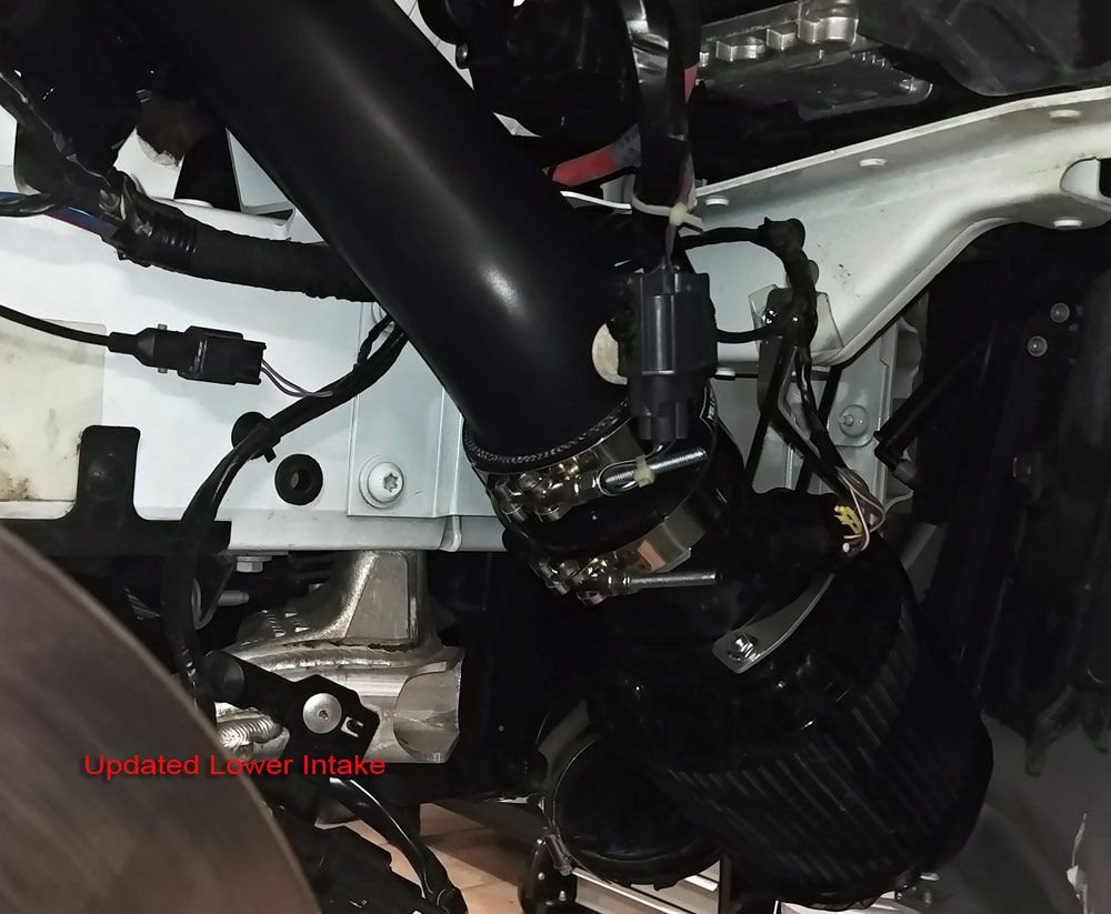

Changing the pulley(s) will not increase the whine very much. The big increase in whine should come from replacing the baffled section of the intake with a straight metal tube. That tube is available with the Mina lower intake kit. That kit comes with an oil filter that probably does not capture as much particulate matter(dust) as a standard paper filter. Perhaps the baffled section can be replaced while keeping the OEM filter box in place. I’m going to try to get to this project this week.
Agree 100% with Unhingd. This is your problem! I have upper and lower intake upgrades, and you can hear the whine until the exhaust kicks in! No issues with a cone filter with the waterproof mesh cover. Based on location and no real openings, should be OK.

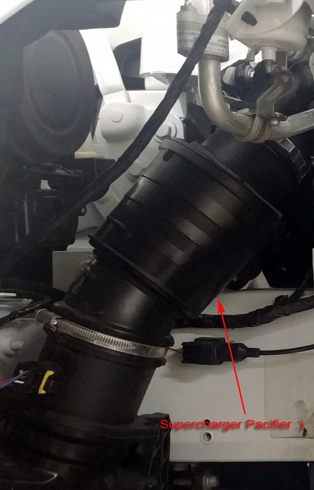

No...The Baffle is part of the lower intake. You can use the Mina upper with the OEM lower, but that still leaves the baffle/pacifier in there. The most sound comes from removing the lower baffle (part of the lower intake) as shown.

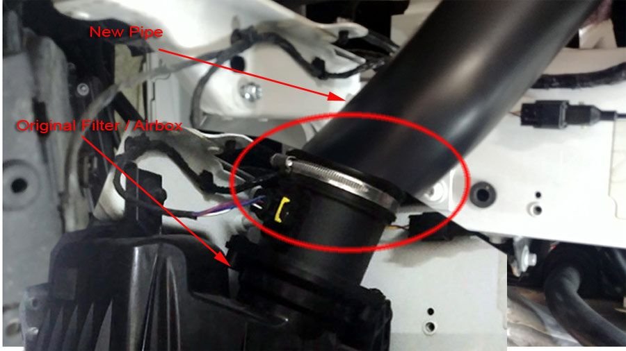

What I mean, is the lower Intake kits are designed to replace the whole lower unit, including the airbox/filter. If you just want to use the "Tube" portion (to get rid of the baffle/silencer), you will need to be sure it lines up/aligns/fits into the factory AirBox. MAy require some alteration? I think Unhingd is considering doing something like that from a previous post?
So you would have to mate up the new pipe and original box like I tried to demonstrate below quickly in Photoshop....my worst work ever, but you get the point. Have to be sure the red circle area would mate up...

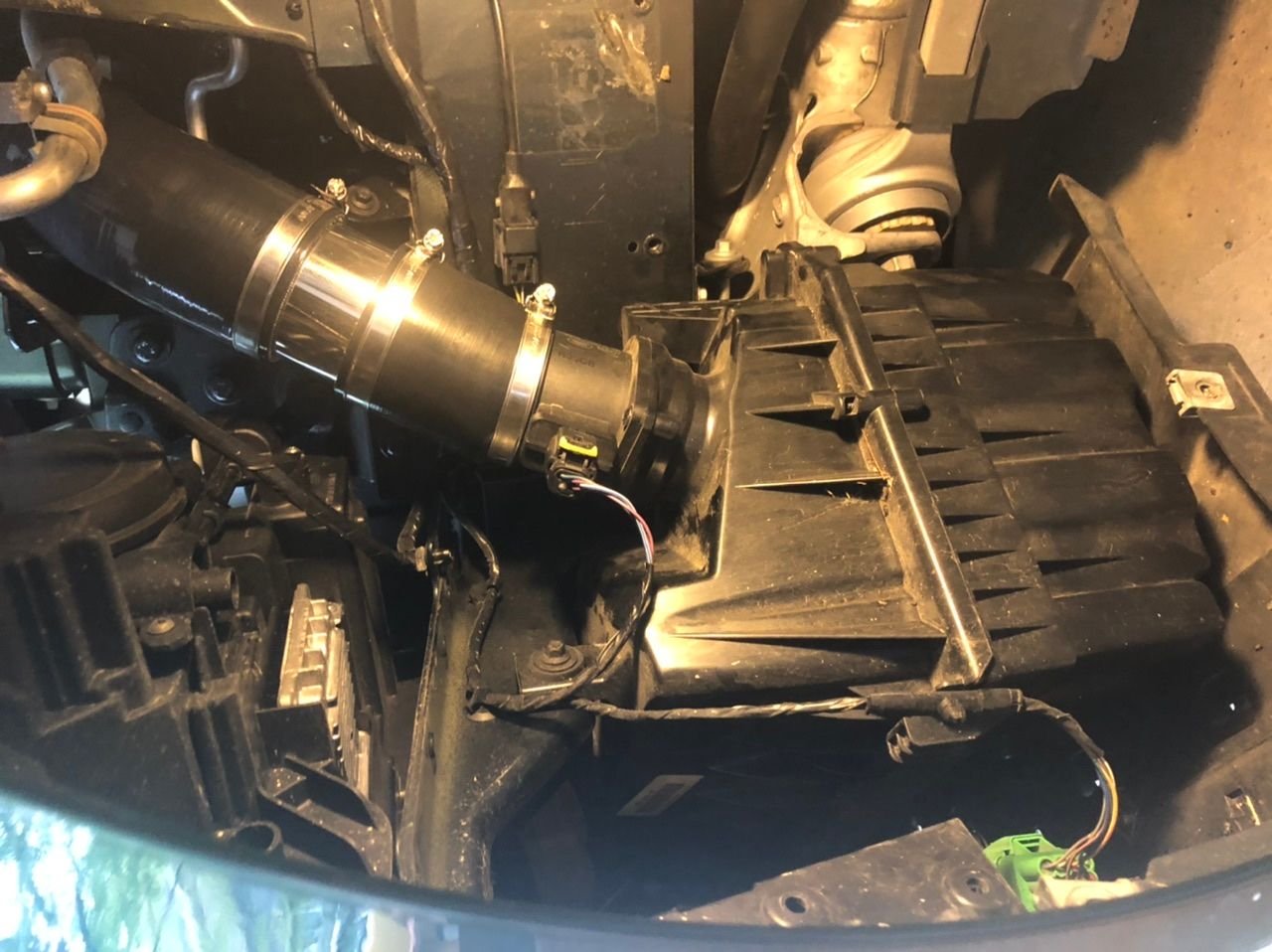

At least on the left side of the car, the OEM filter box can be left in place with the Mina lower intake:

I’ve been tied up playing on the the John Deere doing some erosion control on the stream, so no progress on installing the lower intake on the right side. Maybe tomorrow.
No error code with the left intake replacement. The OEM MAF tube section is used with the Mina lower intake on that side, so I would not expect a code to be thrown.
Yes, I did not install the cone filter provided by MINA.
With just the left side installed, I still don’t hear much more SC whine. The cone filters may be needed to get the SC whine.
