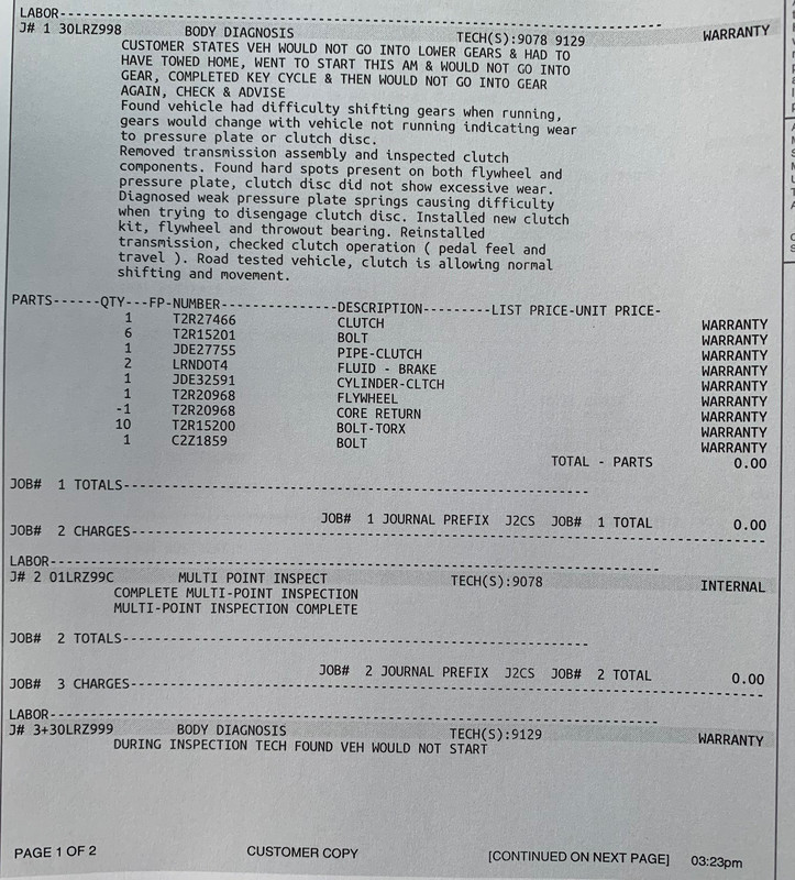

Here's the latest update. On April 21st I received a text from the dealership saying "it's having trouble going in to gear. The is indicative of a worn clutch & clutch disc/pressure plate. Unfortunately clutches are considered a wearable item & is not covered under the factory warranty. I would need to order the parts and can have them here in 1-2 days. The total for the repair would be $4,170.68. Please let me know if you'd like to complete the repair while it's here." Needless to say, my blood began to boil. Then I decided to call and have a calm conversation with my service advisor. I explained to her that I've been driving manual transmission cars all of my life and have never even had a clutch wear out. I told her that I had a 1993 Nissan 240SX that I sold with 110k miles and a 2007 Subaru WRX that I sold with 90k miles, both with the original factory clutches. I went on to explain that I drive my F-Type just the same and don't rag on it. I also told her that the first clutch was previously replaced before I even got to 10k miles. She didn't know that and asked that I allow her to check in to it and call me back. She called back a while later and said that she had spoken with the shop foreman and they felt like it wasn't simply the clutch wearing out. She said that they'd have to take it apart to examine it and would then have to be careful about documenting what they found, but it should be covered under warranty. I didn't press them on time. It took about ten days to order the parts and do the repair. I picked it up yesterday. It seems to be driving perfectly.
As an added bonus, the battery died after they diagnosed the car. The battery on my car dies after the ODB2 port is accessed if you don't disconnect and reconnect the battery. Apparently they were not aware of this issue, so they installed a new battery for free to replace the original.
All in all I'm happy and hoping that it lasts until I can find another new car that I like better (which doesn't seem to be happening).
