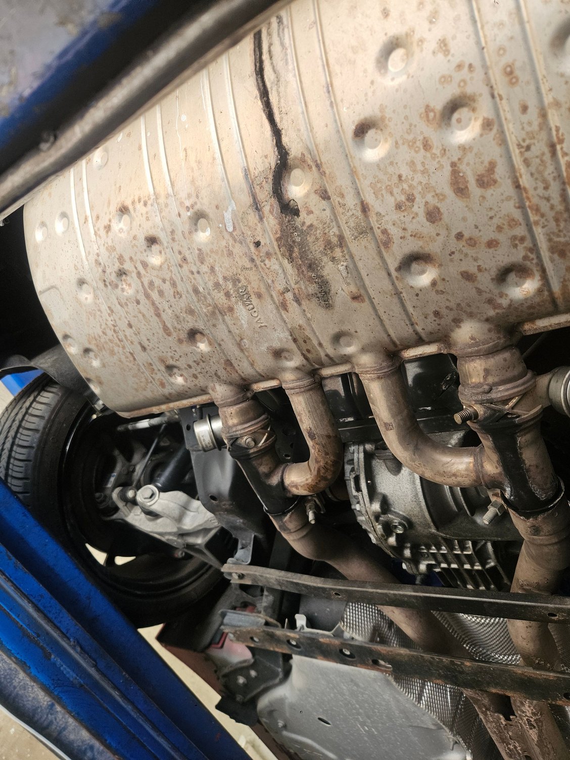

I can't find the drain holes, can anyone point them out to me?
Old Jan 15, 2025 | 04:56 PM
OzXFR's Avatar
Posts: 9,031
Likes: 3,664
See those black stains on the undersides of the joint pipes? Between the two pairs of nuts/bolts.
Then go to the forward most joins on each piece of pipe, and you will see a small half-moon shaped cut out/hole/gap on the edge of the join, that is the drain hole.
Not really a hole as such just a slight gap.
The black stains are dirty water dripping out of those holes and being blown rearwards and the dirty water is a mixture of condensation and exhaust soot.
got it thanks for your help
