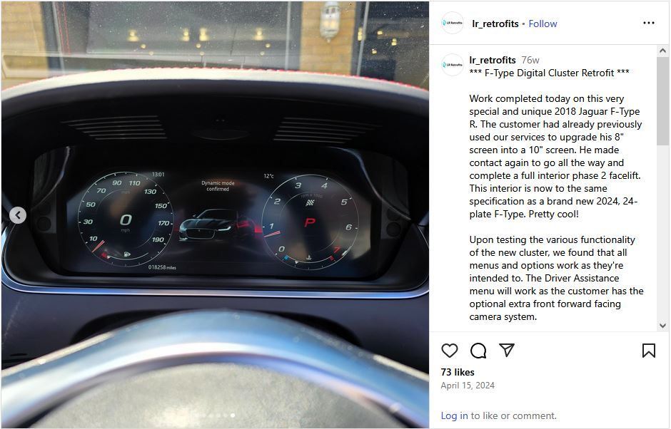

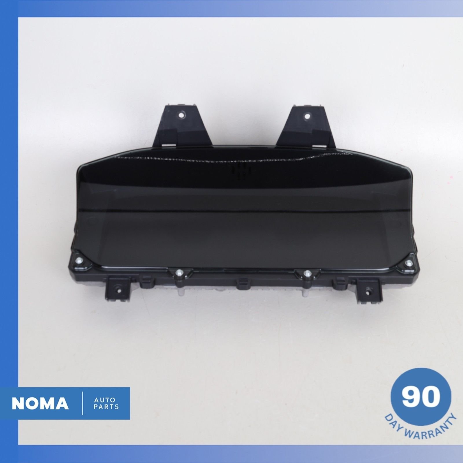

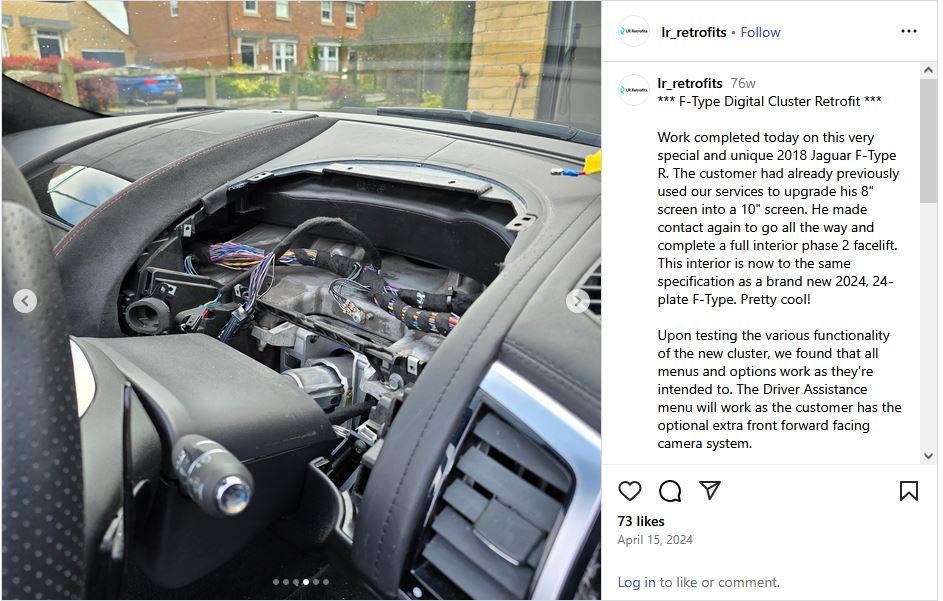

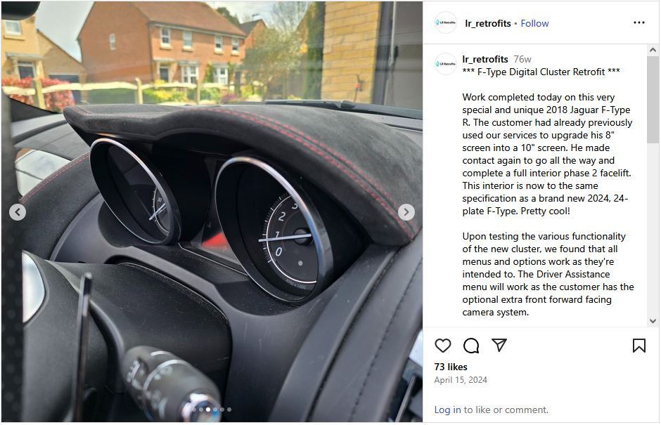

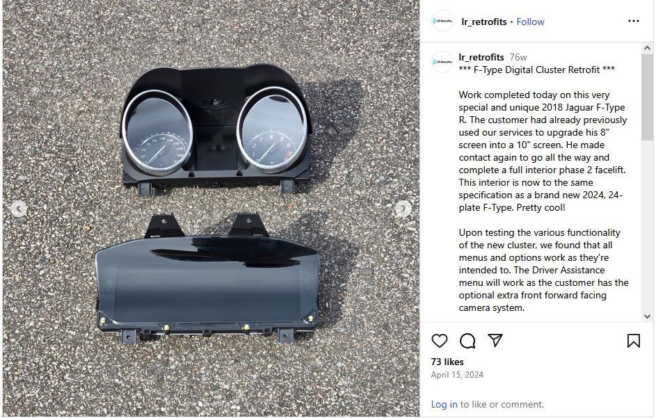

Has anyone done the 2021+ digital cluster upgrade in their 2018-2020 F-type? I came across an instagram post where a company in the UK seems to have done it. I found a cluster and a cluster cover on eBay. Wondering what else I would need to try this. It seems I may need the "interior" black trim that goes around the cluster, under the cover. Hoping to be able to find that part somewhere. Obviously would need coding. I'm waiting for my chinese Pathfinder clone to show up so I can clone my 10" navigation screen upgrade.

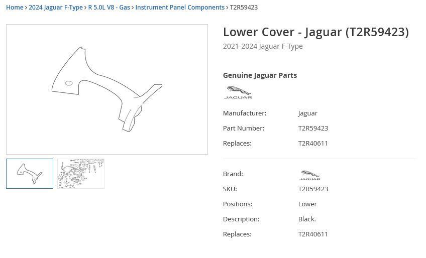

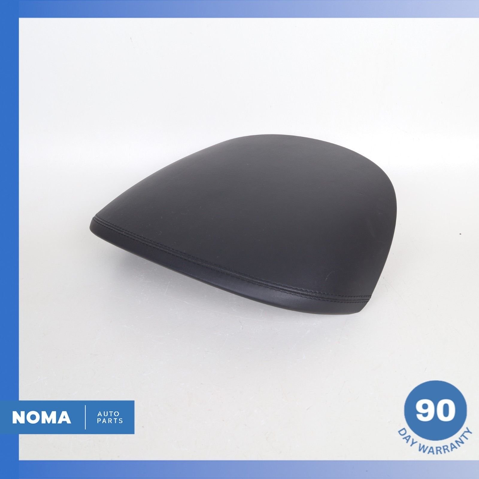

I guess I also would need this lower cover

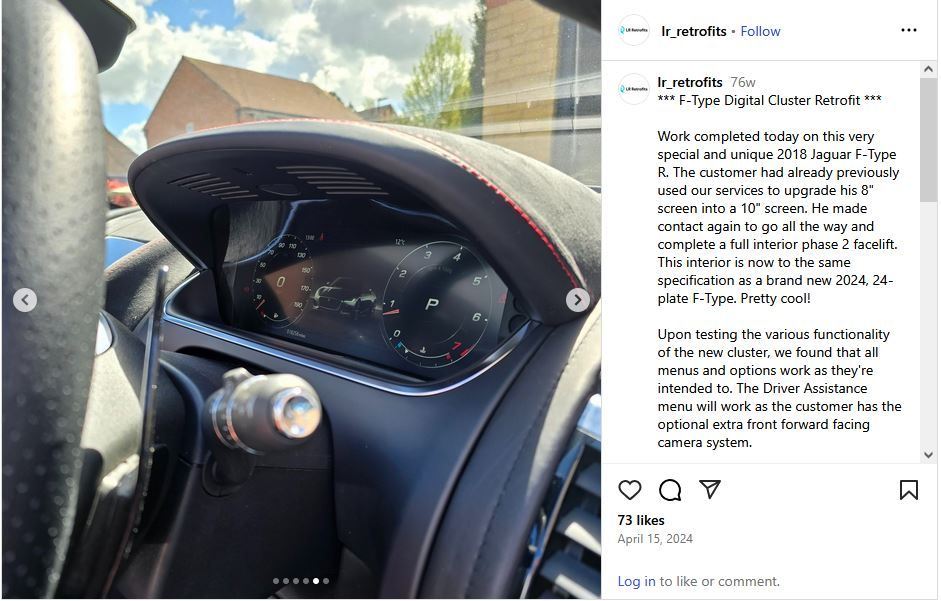

That’s my car that Mo at lr retrofits fitted
Nice. Do you know exactly which parts they used and what programming was required?
Does that retrofit have bugs in dash?
Missing shortscut or something?
I have an svr, and trying to understand if it all work as factory. And if can spec the top speed to 340km as stock analogue svr.
I know there is always something that won't work, as the pro 10 inch retrofit, loss the air config shortcut.
