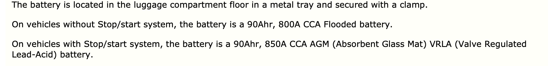

I'm not sure that you need an AGM if the Start/Stop has been disabled (that's the only reason to use AGM over LA).
Most OBD II readers for JLR allow the user to reset the BMS - It is not essential from my understanding, but for belt and braces it's been implemented in the external devices, so to me at least, may have some value....and we all know how tetchy these cars can be with the electrical side of things.
At the end of the day you can simply remove and drop in another 12v source be it whatever technology, and it will work to a greater or lesser degree.
Or, you could buy an equivalent or the same AGM, reset the BMS as it (should), would be done in a dealership..the difference, who knows?

Isn't the charging circuitry designed for AGM which has slightly higher voltages which may have an adverse effect on non-AGM batteries?

Dare I call it a "smart alternator' and "Intelligent charging" system?...it will adapt, i.e increase/decrease V and A depending on what the BMS observes on the -ve terminal, so in theory, no.
The snippets I took from the TopIX are for my car 2015, one battery with DC/DC convertor, so won't apply to dual battery cars from earlier Manufacturing Years. It clearly states that standard LA batteries can be used in cars without the Start/Stop feature, so I assume that this setup is designed and used across a range of JLR products that don't have start/stop also.
