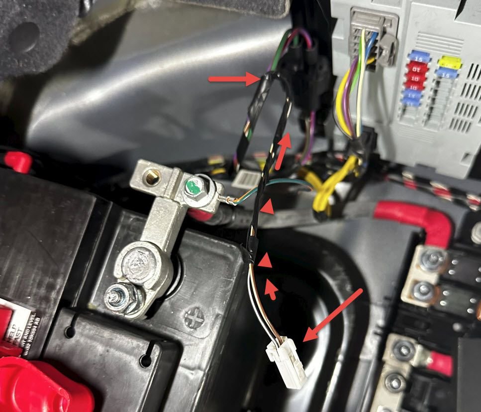

hello - new to me 2014 F Type V8 S - in the trunk found an "extra connector" by the battery - wondering if for some diagnostic plug in or something else - please see red arrow plug and path the wire takes to join a harness .... any help would be appreciated.​​​​​​​ Thanks!

That plug is used when the car is being transported to the dealer. You can ignore it. It gets reported here about every six months or so.

Someone on the UK forum asked this exact question this afternoon!

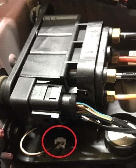

Yes it's "supposed" to be plugged into a dead end socket so it's not hanging out in the open and causing all these questions!
But many dealers just unplugged it and let it hang.
This picture is from an XJ with rear air suspension so the location of the dead end plug is different on the F-Type. Sorry I don't have a picture of that.
You can see the plug has the same wire colors as was posted up thread.
