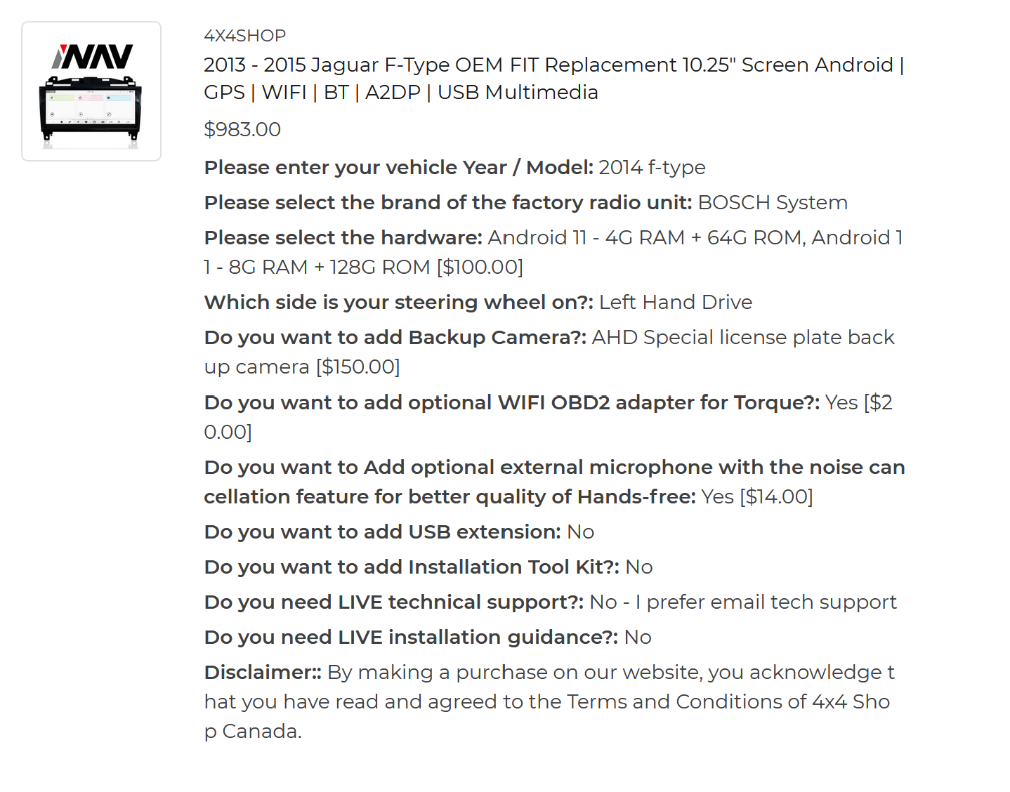

Ordered the following:

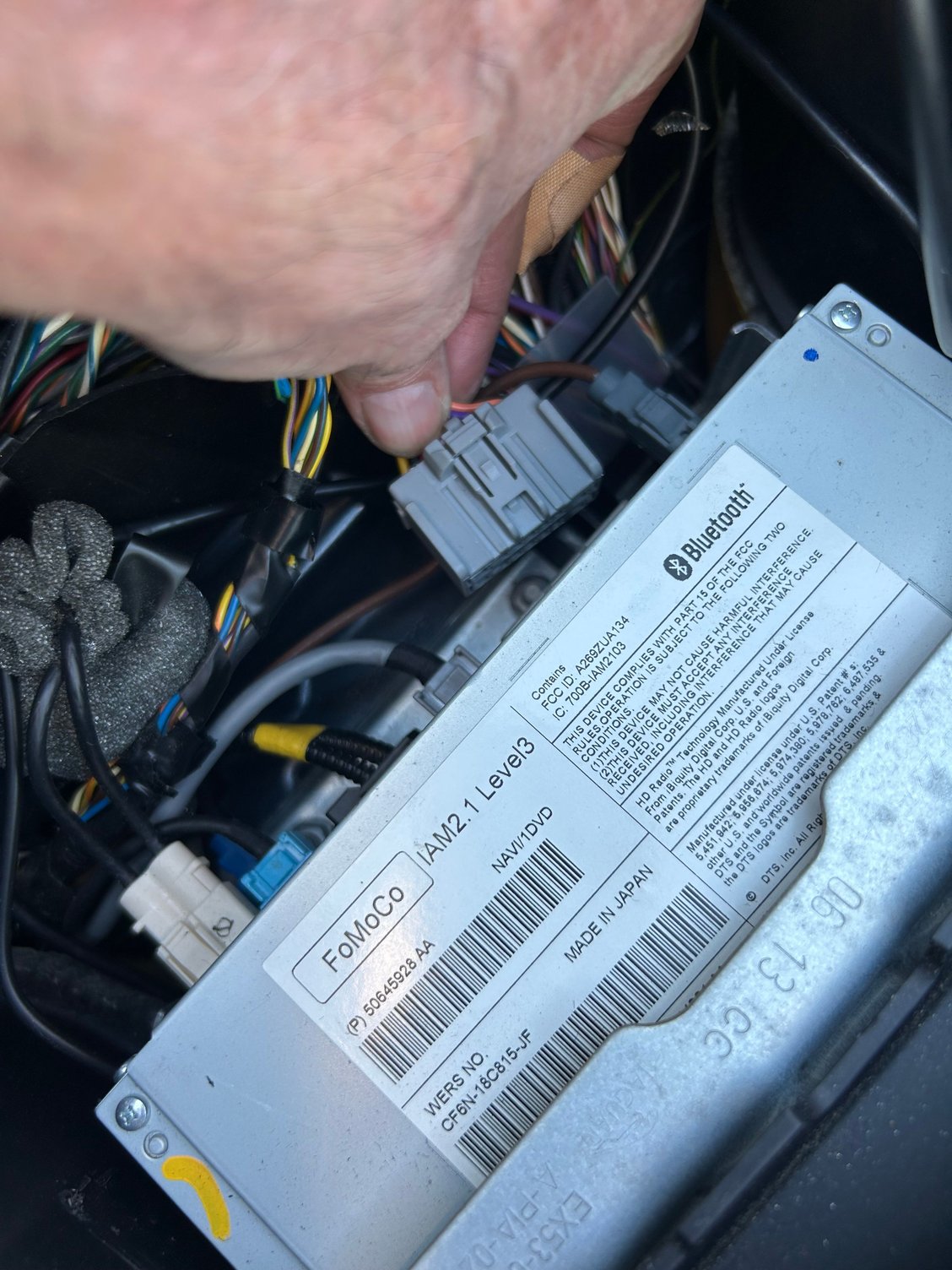

Hi all, i am having a hard time with the install. the cable that goes to the head will not click in. The original cable plugs into the harness and the harness plugs into itself. Any thoughts on how I can make this work?
Old Apr 14, 2025 | 04:11 PM
JagCode3's Avatar
Joined: Jun 2024
Posts: 567
Likes: 279
From: SacTown
@mikerino I would contact the 4x4 support number - they may have seen this before and have some tips.
Is it the right size but just won't click in? You may have to externally activate the clip with a small flathead screwdriver while pushing it in hard. Get a helper so you have more hands.
Old Apr 14, 2025 | 04:28 PM
mikerino's Avatar
Joined: Mar 2025
Posts: 32
Likes: 12
From: NH
Thanks for the reply, I have been emailing support, they told me to "lift up the clips from the plug and re-insert it to the factory radio" not sure what that means. Yes the plug is the right size, goes into the head just will not go all of the way. I did as you suggested and pushed down on the clip with a screwdriver.
