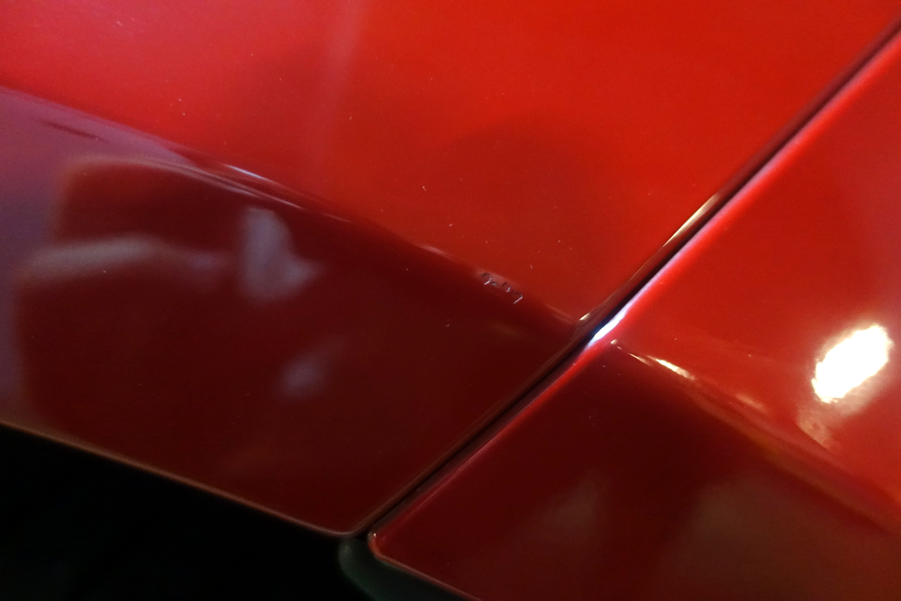

Hi All,
I have a 2016 F Type R Caldera Red and I got a small paint chip in the rear quarter panel, right above the rear tire. It looks like it was hit by a rock.
I am not an expert in car paint, but I noticed that the red paint is still intact, and the damage is only in the clear coat.The damaged area is small, around 1cm in width. Is there an easy way to fix this?
Attached Thumbnails Paint Chip on clear coat-dsc02219-copy2.png   Paint Chip on clear coat-dsc02219-copy.png

Originally Posted by Totti
Hi All,
Sorry to hear. Very frustrating.
(This'll be a little long. Sorry.) I've done many chip repairs myself, though I'm no professional. That said, I see some pretty deep chips that appear to have blown through your clearcoat. I can't tell whether the base coat is damaged as well by your pic. But, what will make this repair difficult is the fact the damage is on a body crease, where pad correction will be a little challenging.
The "all in" repair would be sanding, painting and buffing. A costly process performed by a professional. A much less expensive alternative is correcting the damage by filling the chips with OEM paint, applying a leveling solution and polishing. This technique can yield satisfactory results for most, save the paint perfectionist. The process is only difficult to achieve a decent repair if one is trying to rush the job (as I used to do!), especially if the chips are deep as it appears in your case where the chip damage will likely have to be filled multiple times to build up the repair area to the level of the surrounding paint.
If you're not comfortable doing this repair yourself, you're best off having it repaired by a shop. But, if you decide to tackle the repair yourself, you might want to check out a repair process such as "Dr. ColorChip" here: Dr. ColorChip Automotive Paint Chip Repair Kit - Dr. ColorChip: Automotive Paint Chip Repair Systems Or the "Langka" repair kit here: LANGKA Complete Paint Chip Repair Kit: Repair scratches on your car without a professional paint job! touch-up paint, scratch repair kit, chip repair, Both use a technique of filling the damaged area with OEM paint and applying a proprietary solution to rub off the paint excess to level out the repair area with the surrounding paint.
I've used both products, but prefer the Dr. ColorChip solution because I was able to apply the leveling solution immediately after applying the paint. This enabled me to apply multiple paint applications in succession as need be, whereas the Langka system needs the paint to dry before applying the leveling solution.
Good luck. Keep us posted with your results.

Thanks deltagroup for your comprehensive response. I actually showed the car to two professional repair shops, and both of them advised to repaint the small section around the paint chip (around 5x5 inch), and blend the new painted area with the original paint. I am not sure I want to go this way, as it is not really worth it to repaint as the chip is kind of small.
I was also looking at Dr.ColorChip reviews and tutorials. It looks easy to use and yields satisfactory results. I think the only issue with Dr.ColorChip is that it does not fill chips entirely. Did you get to fully fill chips with Dr.ColorChip?
So I went ahead and emailed Dr.ColorChip asking if they have Caldera Red paint (Color Code 1BD). Unfortunately, they don't. This was their response: "We checked on this color code and we don't currently have a formula or a color chip to match it. We may be able to make an approximate match by a picture.". How to proceed with this??

From the picture, it looks like the red paint is intact and the chip is in the clear coat, so you should not use the caldera paint but should just use clear coat instead.

Here's the deal, Totti. The repair shop sounds like they know what they're doing. I wouldn't go for a complete panel reshoot, but they suggested a 5"x5" area--that I would go for if I wanted to spend the bucks. Since your paint is factory fresh, I would expect an "as-new" repair as one could get. But, since you say the cost of going the professional route isn't worth it (I don't blame you), you can still achieve a decent repair yourself.
You are correct in saying Dr. ColorChip doesn't fill the chip completely. The process is intended to cover up the damaged area, not fill it. However, since I want to fill any chip damage as much as possible, I don't smear the paint after applying. I leave a "blob" on the surface and let it dry a few minutes before using the blending solution. The amount of time the paint is left to dry is the tricky part. You still want to be able to remove the paint using their solution--you don't want to let the paint dry past the point you have to resort to a thinner to remove it!
Filling using Dr. ColorChip takes a little practice. The first few times I tried to leave on the blob, I waited a little too long (drying time varies depending on temp, of course). I had a little difficulty removing the surrounding paint around the chip. I ended up rubbing all the paint out of the chip and had to start over. After a few times though, I was able to fill the chip and apply the solution with minimal impact to the filled chip. I suggest springing for their squeegee too. Made spreading over the chip much easier.
That said, since Dr. ColorChip doesn't have your Caldera Red paint code, consider going with Langka. (Just make sure you pick up a tube of OEM Caldera Red to make the repair.) You'll have to trust the process by letting the paint "blob" dry sufficiently. When you use the blending solution, I suggest you experiment with how you wipe the repair area. Try using top-to-bottom strokes with the blue removal "card" provided in the kit at different angles. If the card is too stiff to achieve a level repair surface, you might find it better to work across the crease in a lateral wiping motion instead. In the end, you may just want to apply successive fills to bring the chips up to the level of the surrounding paint.

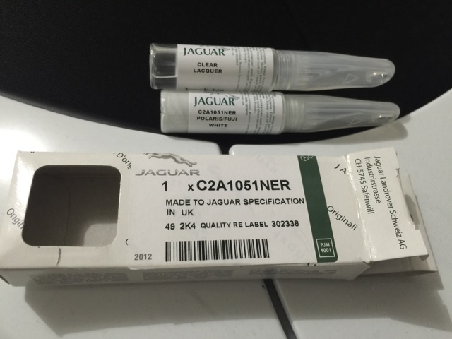

Originally Posted by deltagroup
I don't have a Jaguar touch-up kit so I don't know if a bottle of clear is provided in their touch-up kit. Anyone know?
My Jaguar touch up kit included a bottle of clear.
