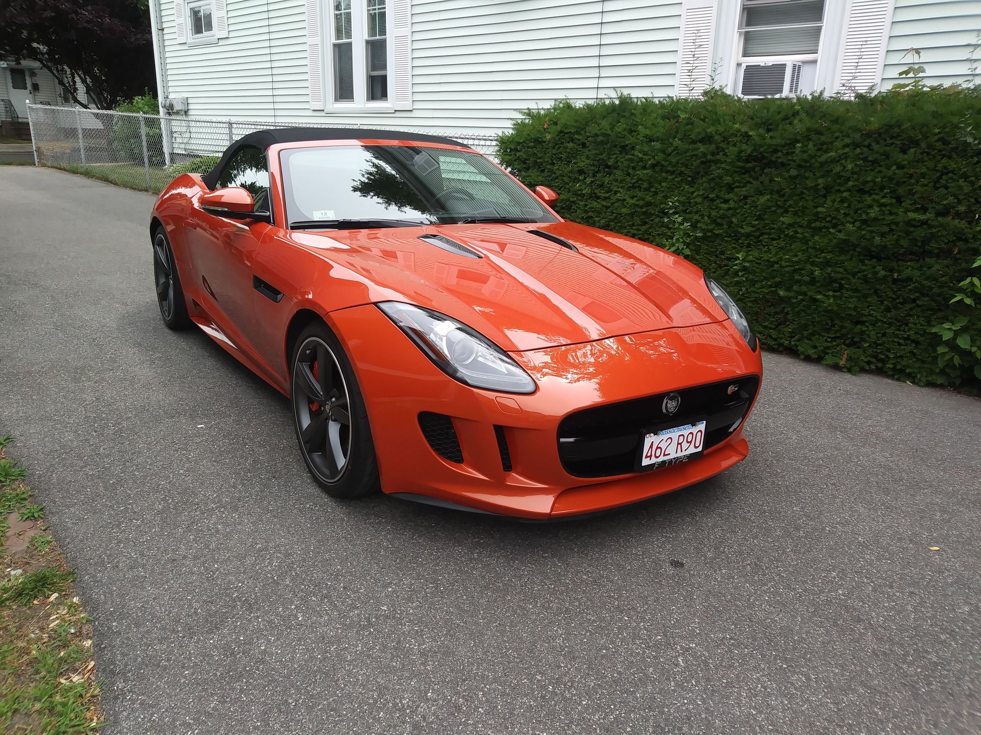

Rupes is a great machine! Used a Rupes on my car.
final finish was hand applied
Polishangel product. I am very happy with the way it came out. I have been told by the pro's that the Polish angel actually get shinier after 12 hrs.
It did appear to.
