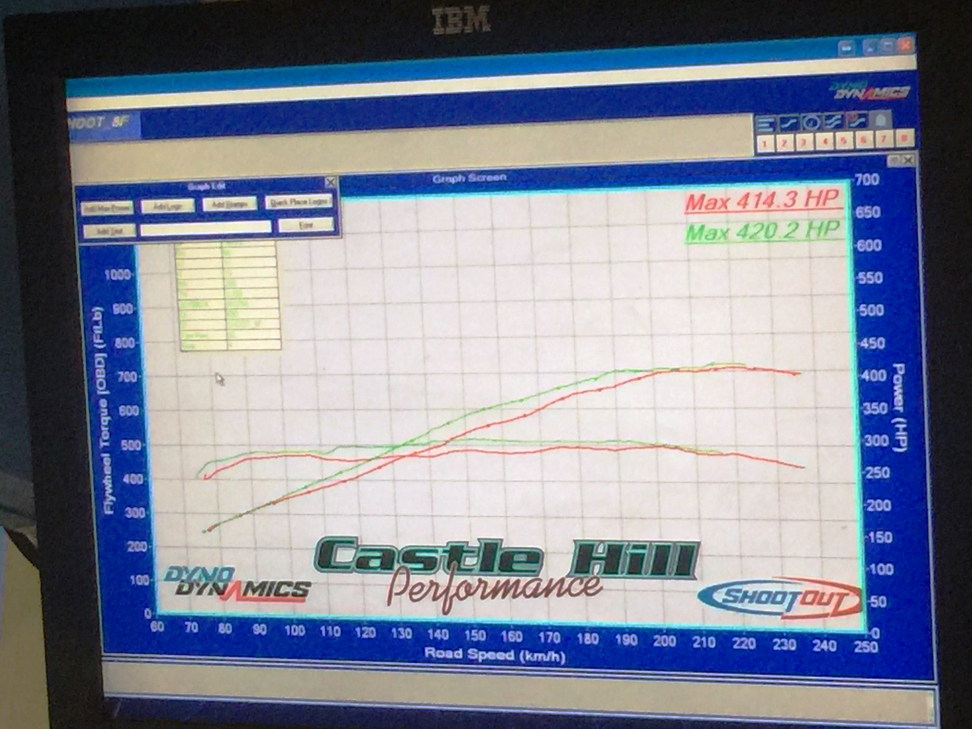

Originally Posted by Cambo
Somehow I missed this thread so i'm a bit late to the party.
We've been working on a V8S on & off the last few months. It's been very interesting, and a few nice surprises too.
Some bad news for you on the piggy back idea Derek.
This V8S was fitted with a RaceChip Ultimate piggy back unit Chiptuning for Jaguar F-Type 5.0 Kompressor ? RaceChip Chiptuning which claimed to take the 495PS/488HP/364kW/625Nm V8S to 608PS/600HP/447kW/762Nm.
No it doesn't.
Ran the car on the dyno, dead stock it made 414rwhp. So from 488HP that would be an approximate 15% drivetrain loss. Not bad.
The big surprise was the torque. Dyno said just under 500 lb-ft at the crank, or 677Nm. This is not the first 5.0L that made a big torque number like that. But it does make you wonder, is the 5.0L underrated for torque? Seems so...
Now for the RaceChip. They claim +23% in power & torque over stock. The reality is quite different. Peak numbers were just 420rwhp and 515 lb-ft. Which is a total flop. Yes if you look at the curves on the dyno sheet there is a gain mid-range, and this is noticeable behind the wheel. But the outright numbers, not even close to the claims given.
Dyno sheet:
Attachment 121124
Now it's important to understand why. How does the RaceChip work? It intercepts the MAP (before the S/C) and the TMAP (after the S/C) and tells the ECU that the manifold pressures are low. So the ECU "should" respond by allowing more boost, by allowing more throttle. But it doesn't work out that way.
The Bosch ECU is extremely complex and has some incredible failsafes built into it. If it detects an implausible measurement from a sensor, it will just ignore that input and use a different measurement to run the engine.
The ECU is programmed so there are "normal" values for MAF rate and MAP/TMAP signals, at a certain rpm, throttle input & load. If for example, the MAF rate is "out of spec" it get's ignored and the ECU runs the engine using the MAP/TMAP (like a MAFless or speed-density tune). Likewise if the MAP/TMAP is out of spec it's ignored and the engine runs off the MAFs instead.
So this RaceChip piggyback unit is most likely rendering the MAP/TMAP inputs useless, as the ECU will be ignoring them. So it's running off the MAF's instead, with the factory-defined fuelling/timing/throttle for MAF's only, which would explain why there is only a small difference in the actual power output.
You can actually unplug the MAF sensors and the engine will run just fine. The danger would be with a piggyback fooling the MAP/TMAP inputs the ECU is relying on a faked signal to run the engine.
This was not tested because the outcome is totally unpredictable. Worst case the engine could be subjected to maximum throttle with no torque limitation, which might make incredible power, but also result in a catastrophic failure of the engine or drivetrain. Who knows??!
It was very important to understand what this unit was doing, because we were going to flash the V8S with an R tune.
Now if you were to make a piggy back controller for these cars, it would have to override just about every sensor that goes to the ECU. I mean MAF's, MAP/TMAP, possibly also the O2 sensors. It'd be a very complex device and would be extremely difficult to set it up properly so the ECU doesn't ignore the measurements.
