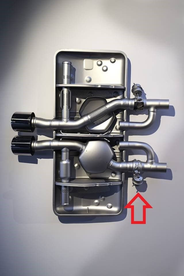

1) What V6 cars (model years/trims) are equipped with the active exhaust (no button)? And is there any way to tell if a car has the active exhaust (non-switchable/no button) or non-active besides driving it? I’ve been seeing some conflicting info on different threads.

You would need to look under the car (or get pictures) to see if it has the switchable exhaust (if the switch on the console is not present).
I've arrowed the actuators that you should see, one on each pipe just forward of the muffler.
