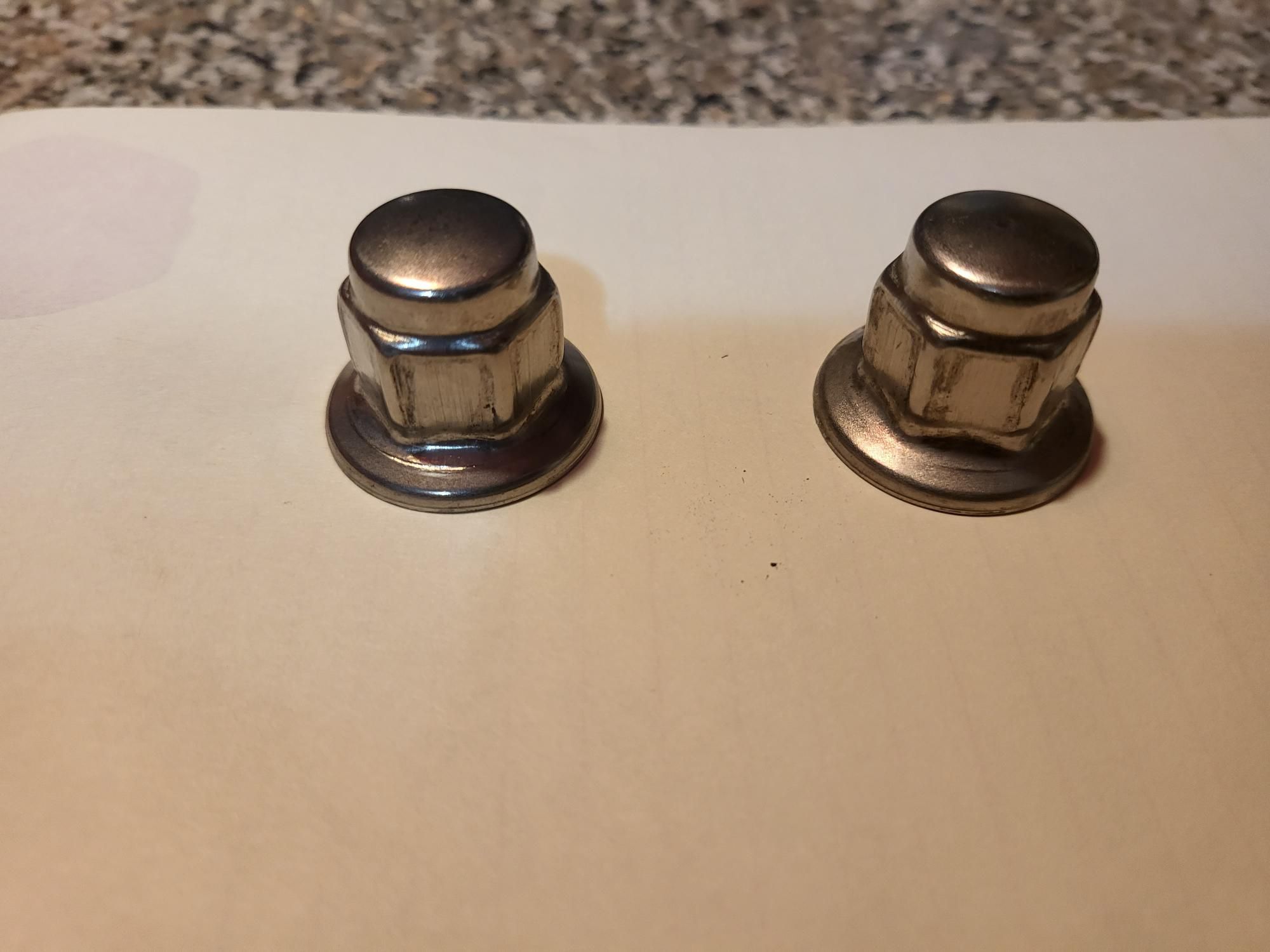

When the two lug nuts broke off, they broke at the base of the nut.
These are what broke off.
This is the inside of the lug that broke off.
This is what is left of the lug nut on the wheel stud
The other 3 lug nuts are still stuck on the wheel, I've just been feeding them a bit of Liquid Wrench every day, but still they will not budge. I am not forcing them as much as the two that broke. Just using a long manual lug
wrench.

While out doing other things I stopped by my local Tire & Auto Shop and I showed them the above photos, they said they could help. As the 3 remaining lugs were just stuck, and the base of the 2 broke lugs were still tight on the wheel studs I was able to drive the Jag just fine to the shop.
Once in the shop the 3 stuck lugs came off finally with their air hammer wrench (Win #1) which I could not do with my battery lug wrench. Then they notched into the base of the broken lugs bases and zipped them off with the air wrench and smaller hardened socket (Win #2). The whole process only took 20 mins and only cost $20!
Remember, this was NOT a just a case of rounded lug nuts, the WHOLE main body of the lug nut broke off, leaving just the last threaded base of the lug, and the lug washer on the wheel stud.
