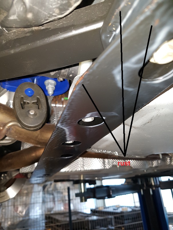

I do have after the first year quite some rust on the exhaust and other parts underneath the car ... Is this normal? I drive in Switzerland and they told me that this was a car which was imported from Gibraltar and therefore it has another "conservation" .. can this really be true?

Pictures, please. Hard to believe since everything under there is either stainless steel or aluminum. I could understand if the fasteners are rusting.

Over the years Jaguar have consistently managed to find a grade of stainless steel for their exhaust systems which rusts in the northern European climate! However, I'm surprised a recent ex-Gibraltar vehicle would be affected.
The Jaguar Land Rover distributor in Gibraltar is A M Capurro at 20 Line Wall Rd, Gibraltar GX11 1AA (tel +350 200 75149). I keep their details in my phone as I drive down to Gibraltar most years. A call to ask what they know of your vehicle may provide some useful information on its history.

unfortunatly all steel parts e.g. the subframes aren't protected sufficiently against rust .
https://www.ftypeforums.co.uk/viewto...07&hilit=rusty
Even on my car which has been driven only 3 times in rain during the last
4 years you can find some rust on these parts .
Definitely not build for winter use .

Would it be worthwhile to spray it with oil, or is it likely to create more issues?

They spread rock salt on UK roads in winter to prevent ice build up. If there's any stainless steel and aluminium in direct contact, that would be bad...

Your properties of materials must be different on that side of the pond. Here, salt will not affect stainless, and the surface oxidation on the aluminum (maybe not on aluminium ) actually protects from further corrosion.

Think he's referring to the fact that if stainless and aluminum are in contact with each other, galvanic corrosion can occur. But presumably, that would simply be bad design.

Yes...that be true. The stainless pipes are physically isolated from the body with rubber mounting blocks.
