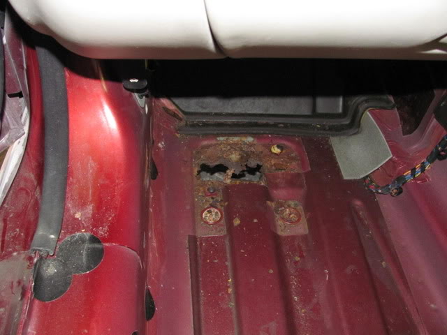

I have found a 2000 with 100,000 miles fur just under $10,000 which I have determined has the Nikasil but shows no smoke and runs great so I'm not to worried about it. No noise on startup but I would do the tensioners to prevent a problem. My concern is there is a metal plate under the drivers footwell near where the crossbrace attaches. It has advanced corrosion and actually has a hole rusted through the middle of it. Is this a big concern or a no big deal?

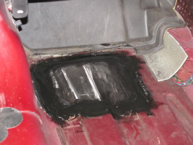

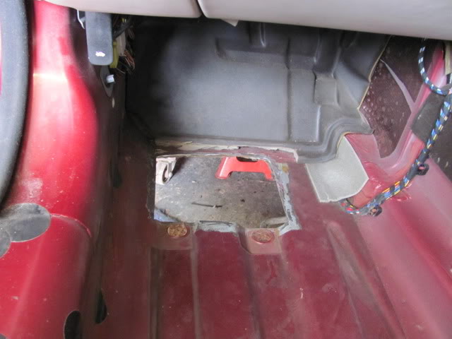

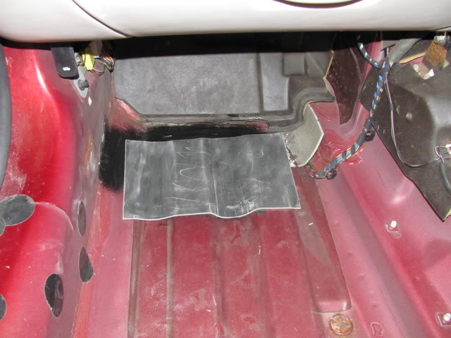

I put these pics up on another thread but here you go

I now know someone producing a proper repair section for this problem if you are interested.
Old May 21, 2012 | 03:19 AM
It's a consequence of the manufacturing process and not an indication of sloppy maintenance.
The plate under the vehicle is used on the production line. When the seal breaks down and water gets trapped, it rusts through the floor.
Other than the work involved in stripping the moulded carpet out of the way to access the floor, it's not a difficult repair.

Thanks for the pics, XKRacer! That sure looks like the area where I saw the rust on the one I am interested in. I'm going to have to take another look at it and see how advanced it is. At least I know it is repairable.
