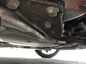

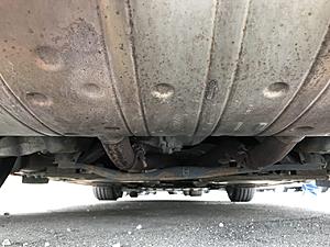

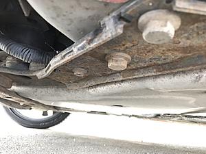

But I was a bit shocked how rusty the exhaust was and some parts in front of the rear wheels. I forgot to make pictures of the exhaust tips but I made some from under neath the car.
I am not a car specialist nor did I see other older F-Types before but for 3 years it looks quite bad I think. My 5 year old Mustang looks better.
I attached the pictures thank you for looking at them.

All of this is surface rust, except bar going across exhaust. 2014 car is 4 years old, not 3.

Doesn't look "bad", however it also does not look "loved". If the price is right...
The finish (powder coat I think) on the mild steel cross members and brackets under the rear axle is very thin and poor.
Quite a few cars over this side of the pond have gone back to the dealers to have this rectified/replaced.
It is a known issue, and if the dealer doesn't replace, then they will prep and finish it off like new again.
I covered mine in Quicksilver Corrosion guard form new, and recently put several liberal coats of Waxoyl on it...still looking good.

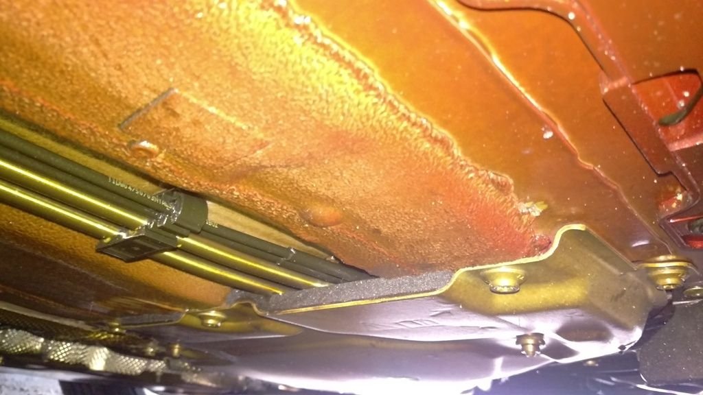

This is what mine looks like after 3 years. I had the same "worry" and applied some anti rust coating.
