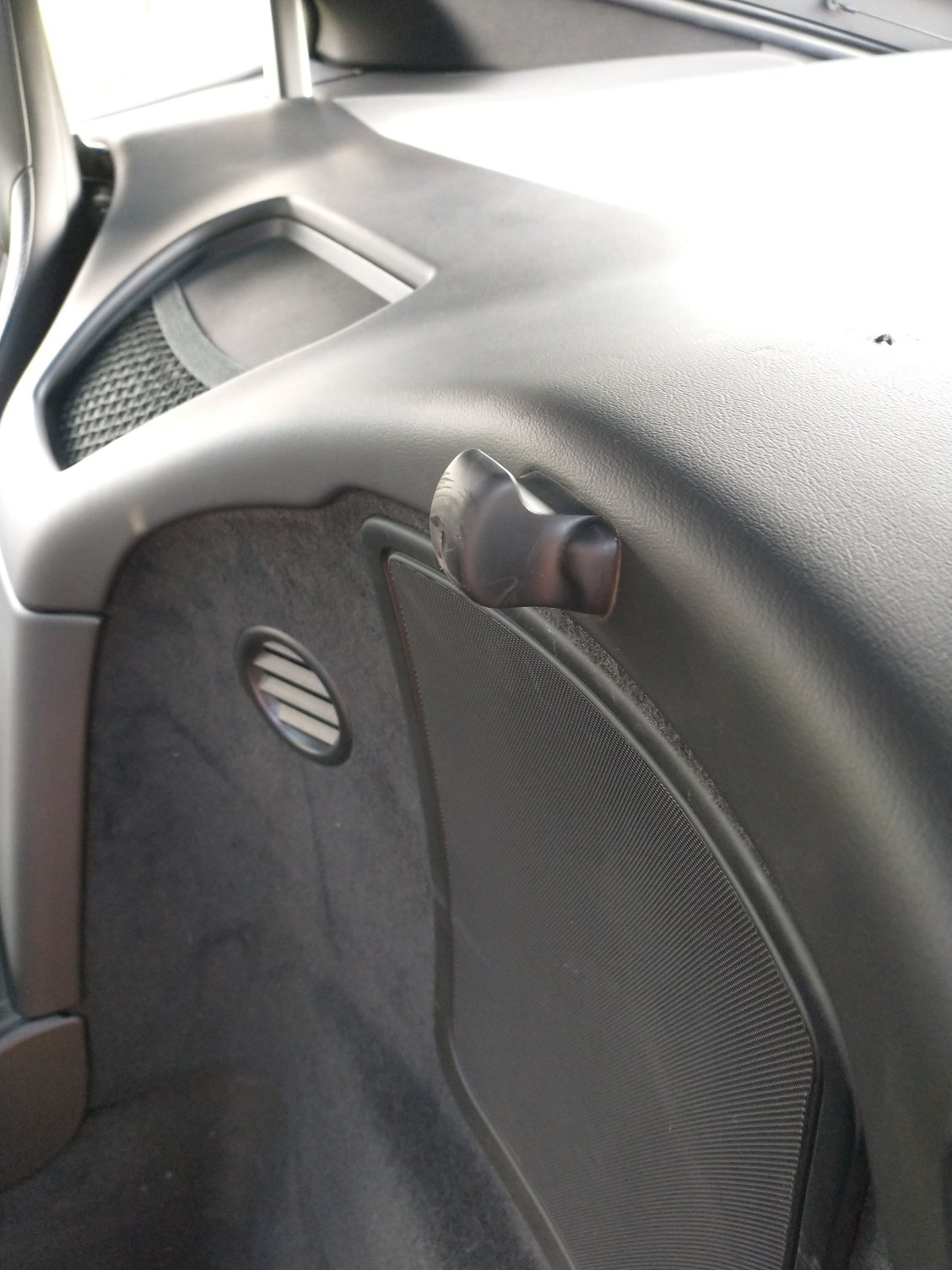

Unfortunately, this is not..'exactly' accurate. While the designed space in the rear of the seat "can" move around the coat hook, it can only do so IF and when the seat is raised substantially higher than a "normal" seating position. With the seat in it's lowest position essentially sitting on the floorboards, there appears to be over an inch and a half of space between the seat and the bulkhead behind the seat. Those with longer legs will want to "reclaim" that space. (See attached images)
This limitation appears to be due to the design of the "coat hook" pushing the seat back forward due to the seat back design (e.g. the gap does not extend high enough on the seat to permit the hook space so... the hook just ends up pushing on the back of the seat forcing a more upright position that would be ideal).
My question is "Has anyone REMOVED that pesky coat hook all together so that those of us with long torso bodies can have the seat at its LOWEST position AND also have it pushed all the way back"?
PS - After reading the balance of the posts in this thread I decided that removing it would be... shall we say.... "un-wise".
After a fair amount of time tweaking the settings I think I have recovered a lot of the empty space behind the seat without having to raise the seat any higher than necessary.

Not thrilled with the design of the coat hook or seat settings on my 2018 400 Sport coupe. I'm 6'5" and need all of the leg room I can get. Apparently where I place the seat put enough pressure against the worthless coat hook that it fatigued and punctured the back of my driver's seat. I quickly decided that the coat hook had caused way more damage that any good it will ever do me so I removed both. I used a Dremel tool for the first one which made a mess and took awhile but I learned it is 2 small screws holding it on so the second I removed with a large vise-grip pliers and just pushed the screws out the back of the top trim piece. It leaves 3 small holes which I'll cover with some black tape but in reality they aren't seen unless someone is moving the seat forward and looking behind it.
If you have similar seats and keep your seat back against those stupid coat hooks, I'd suggest being proactive and removing them. Really poor design placing something behind a seat that can puncture it and/or not placing a physical stop on the seat from preventing it from hitting it.
