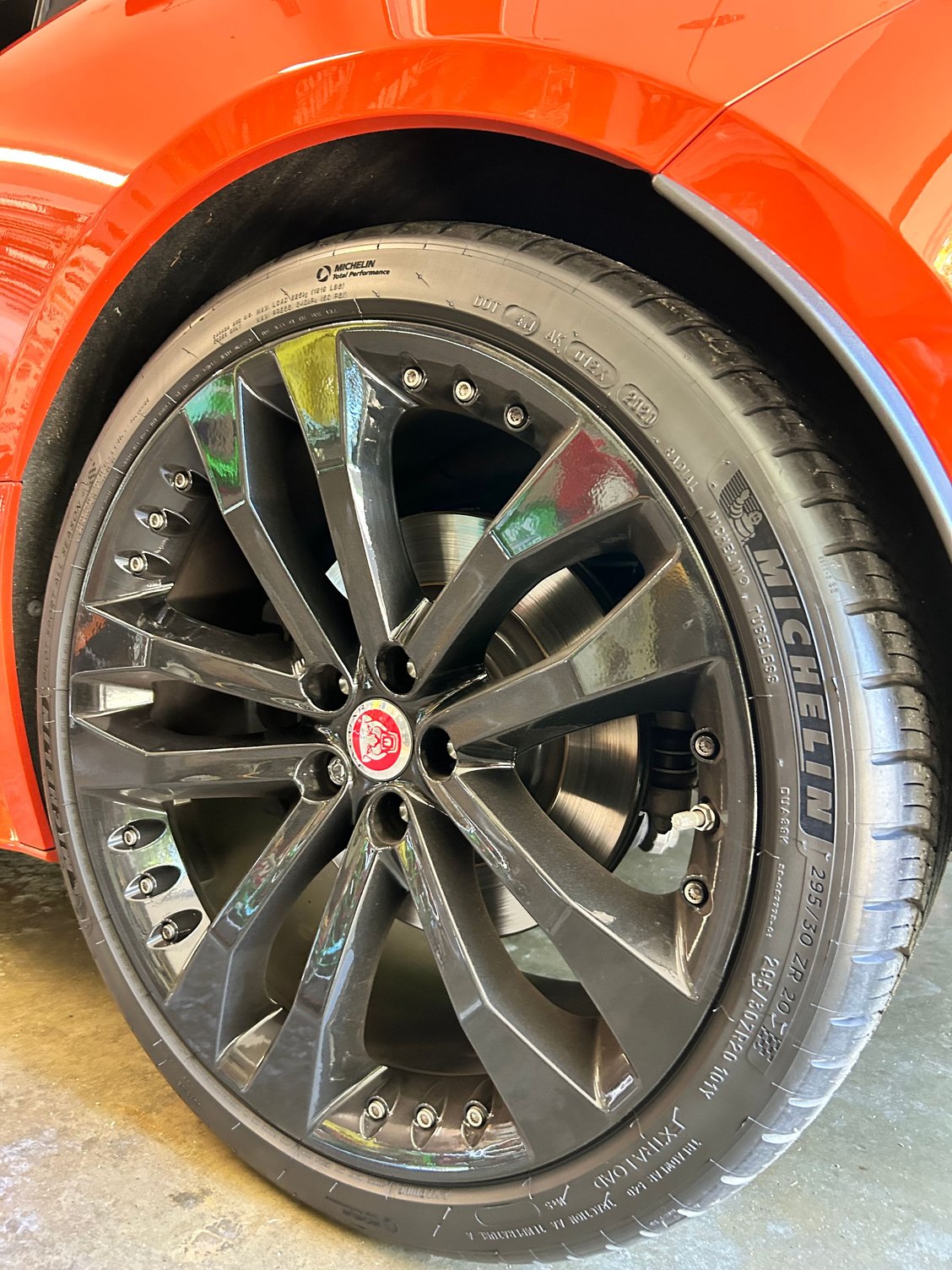

I tried to fit the TEEZE 15mm spacers and unfortunately they would not fit cleanly on hub-centric hole, it was too small. I am going to return them and look for another brand.

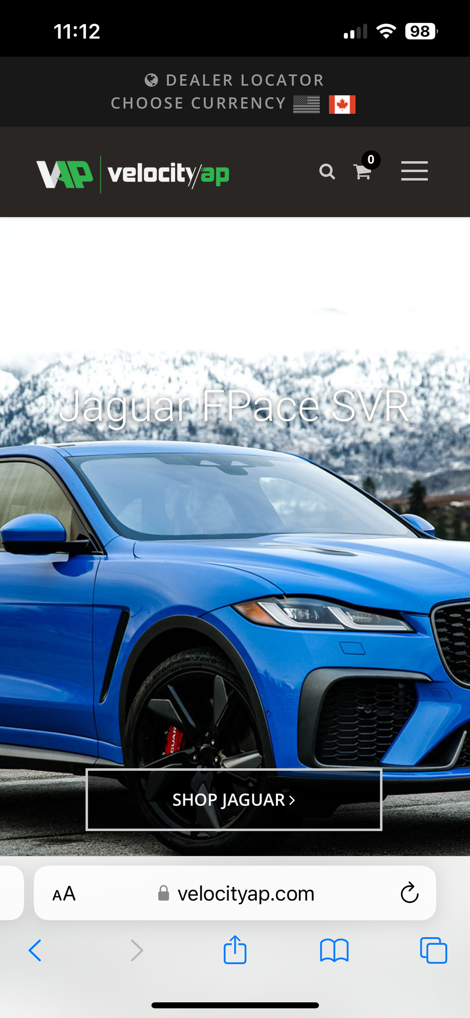

I just ordered the VAP’s…. Hopefully no figment issues..

Let me know, and if you don't mind posting a link, that would be great.

Thanks! Do you have the 20" carbon fibre "Blade" wheel rims? Just wondering if the recessed area on the back of the rim will the allow the stud / bolts fit without grinding them down. The TEEZE spacer specs were the same bore measurement, 63.4mm but it just wouldn't "sit" correctly without rocking.
I am no expert, but I believe I read that the blade rims do not need any modifications
Yep, confirmed many times by myself and others that the Blade wheels fit over 15 mm spacers fit no worries with zero grinding or trimming of the wheel studs.
Funny about the Teeze spacers, I have fitted three sets (2 x 15 mm and 1 x 20 mm) and they all fitted perfectly.

I was with the tech and when he tried to put the Blade rim on the Teeze 15mm Adapter/Spacers and it just did not align on the collar (?) properly. I may try another shop before I look for another brand. Maybe I got a bad set. The shop seemed reluctant to fit none stock equipment, maybe they "tried" not try to make it work on purpose, but I don't think it should require too much force to get the rim on. or am I wrong?. I don't have the tools, or confidence to do it myself.
Not sure if you are saying that the hubs/rims on the spacers are too small (ie the wheel goes on but it wobbles too much) or they are too big and your tech just can't get the wheels to fit over the hubs/rims.
It can be a bit fiddly fitting the wheels back over the rims/hubs of the spacers, they are quite a tight fit but it should not take any force to fit them nice and flat and even with no wobble, you just have to line them up perfectly.
It was only a few days ago now (six days to be precise!) that I swapped out the rear 20 mm Teeze spacers for the previous 15 mm Teeze spacers and I had zero problems, other than the fact that those rear wheel/tyre combos weigh a ton and I'm not as strong as I used to be!
Edit - just a thought - maybe the insides of the wheel centre bores have some crud or rust or build up on them which can be cleaned off and then the wheels will fit?

I appreciate the input, yes there is some material build up, but it is very slight. I guess I'm also having second thoughts about going through with this modification now. The Mrs is not too thrilled about the idea either. As a designer, by trade, I struggle with changing the original Callum design, and I took another look at the set up I have and I think it looks great as it is. Then there is issue with my insurance and coverage/liability. The roads here are generally not good so I'm not going to lower it either. I may just go with the 305s on the tyres which need replacing and I think they will look great. That being said I may revisit the spacers in the future.
