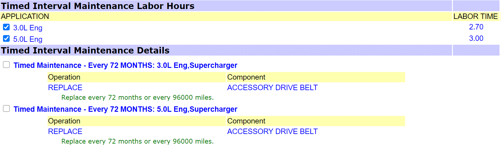

I have a 2014 F Type base. The service manual says that the supercharger belt should be replaced at 6 years. I only have 31,000 miles on the car and it is garaged.
Has anyone had this service done yet? Is this something that could be done by an at home garage mechanic? If not what type of bill should I expect. It would seem
to me to be primarily a labor issue. Is it necessary to change the belt with such little mileage on the car?

Yours is based on timing as opposed to mileage, and yes it can be done as a DIY. I have a link below on my drive to help you if you try it, as well as the Maint Schedule.
How To Here
