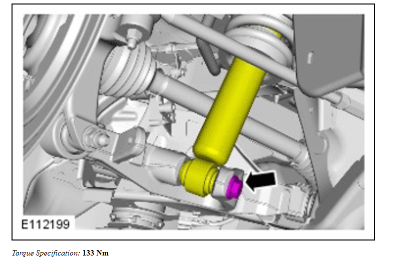

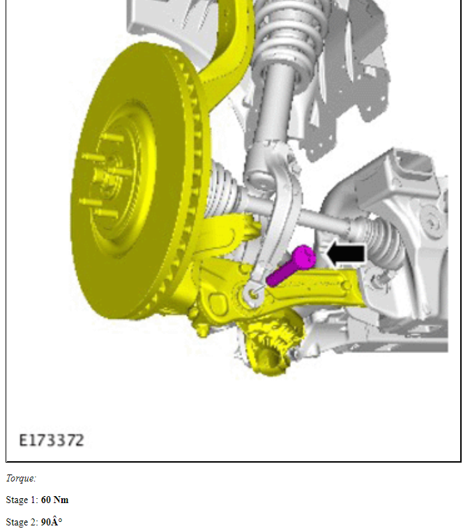

Front:
Rear:

Originally Posted by Therock88
Front:
Rear:
DC
That upper diagram is definitely AWD where mine was not. That shows an initial torque and a final torque to stretch. I'm assuming that means 60Nm and then 90 degrees. The RWD repair manual is definitely different for the front than this. The rear is the same as what I have.
Old Oct 4, 2021 | 06:54 AM
Therock88's Avatar
Joined: Nov 2019
Posts: 1,506
Likes: 1,031
From: (Illinois) - Led by Gov. PRICKster
Yes...Correct. Per the OP signature, has a 2016 R, so would be AWD.
