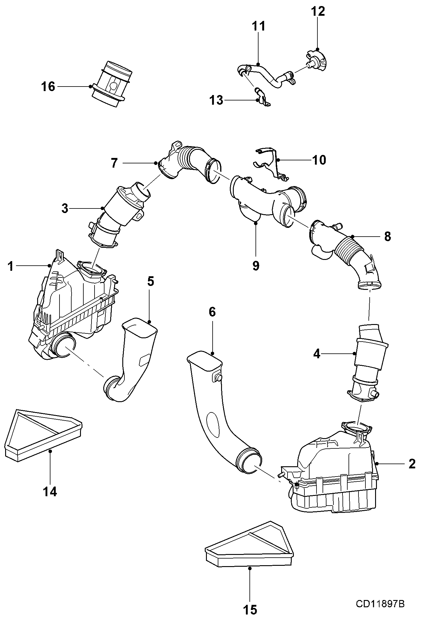

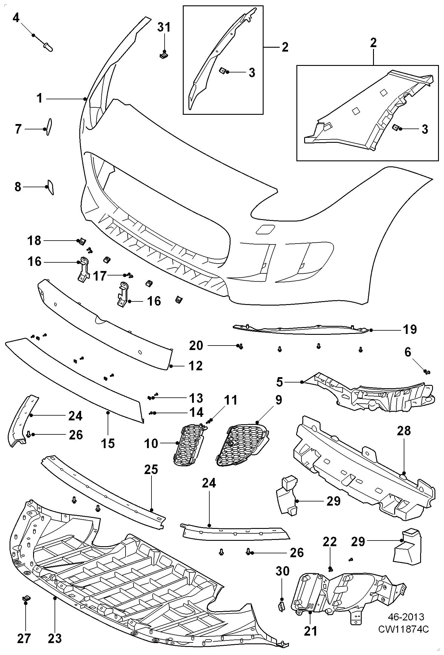

Originally Posted by Foosh
After looking at the Eventuri site, it looks like you can get to the OEM intake by removing the front wheel and fender liner. That would be a whole lot less labor intensive than R&R of the nose.
Cambo, you're right it's not a huge big deal, but probably a bit more than the average shade-tree mechanic wants to deal with.
If you have a hoist then removing the front wheels, wheel well liners and bumper undertray would probably be not that bad, but if the car stays on the ground then bumper off looks easier to me.
The stock airboxes have the panel filter at the bottom of the box so the undertray of the front bumper would also have to come off.
Thoughts on This Spectre Air Intake Mod...-cd11897b.png Thoughts on This Spectre Air Intake Mod...-cw11874c.png
Everything gets easy with lots of practise, I can get the bumper off the XJR in about 10 minutes now. The first time took me an hour...

Originally Posted by OzXFR
Minor thread hijack, but I always thought the vents each side of the grill channelled fresh air into the intakes, but just now I had a close look at these vents with a torch and they are dummies, completely blocked off by black plastic panels behind!
So how/where exactly do the intakes pick up air?
And can those blocking panels be removed without causing any problems, and would removing them improve the air flow to the intakes?
look at the parts diagram. Parts 5 and 6 are "snorkels" which I assume are around the front bumper bar. They direct/suck air to the airboxes that have the filters
Yep, that's apparent. I just had another look and the inlet ends of those snorkels are not in any direct airflow I can see, maybe there is be a simple way to improve the airflow into the ends of those snorkels?
