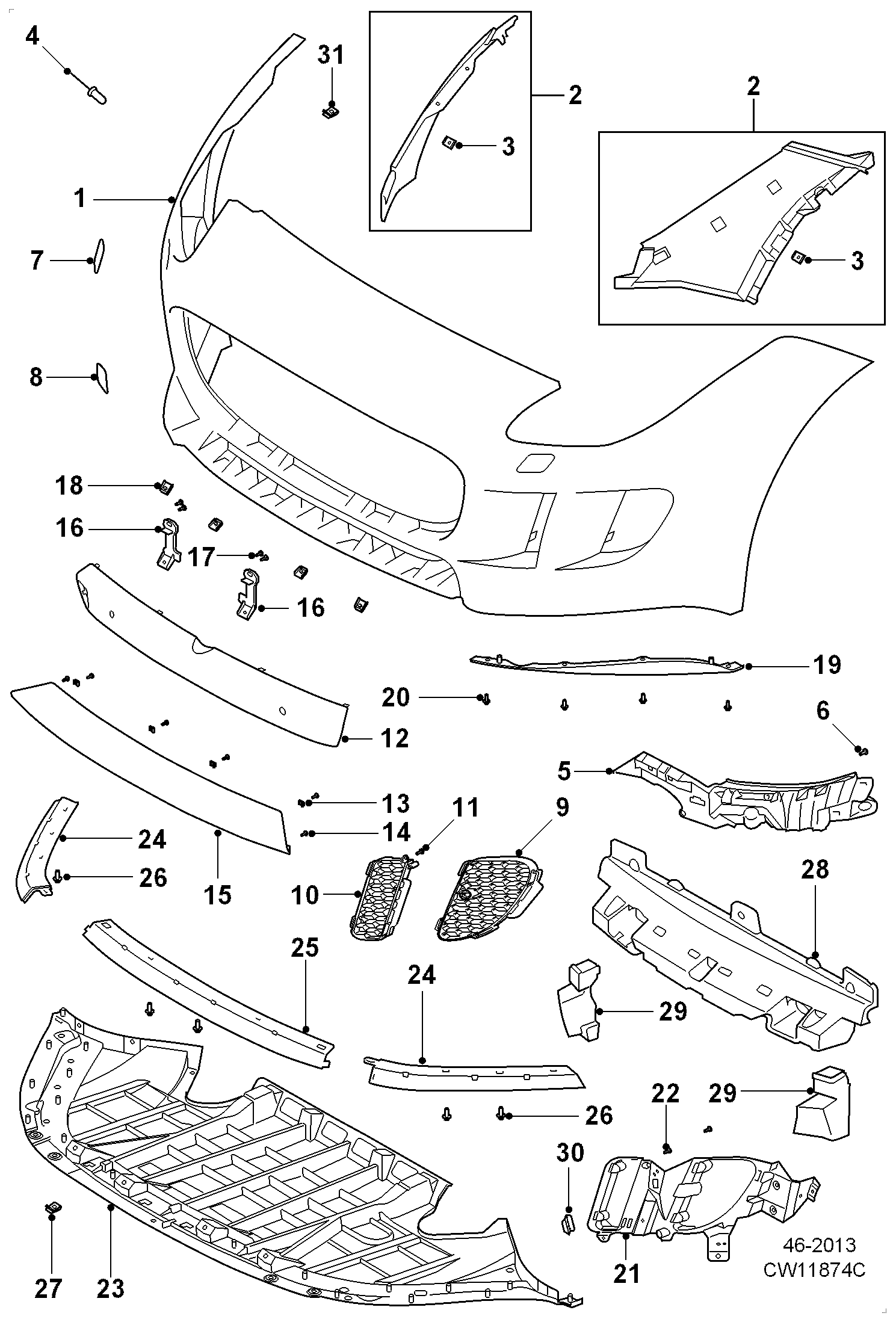

I've had a closer look at the intake snorkel set-up per the Repair Manual, and it's now obvious to me that the tops / openings of the intake snorkels sit well above the height of those dummy vents each side of the grill. It looks like the intake snorkels gather air coming in through the top part of the grill opening. So removing the blanking plastic behind the vents would not improve airflow into the snorkels one little bit, although it might help with brake cooling (and I understand this is where the special track-day cooling ducts are mounted).

If you could somehow extend those snorkels to the front grill to create a RAM air effect that could indeed increase horsepower once travelling at speed due to a ram air effect, could be something worth pursuing.
Its something Porsche do on their air box designs in the 911 as the rear decklid is an air collector with a snorkel sealed against it which rams air into the sealed air box, can't find the documents but Porsche claimed at 70mph this direct ram air gained around 10 horsepower at highway speeds due to RAM air effect and of course only pulling air from the grill area is cooler and thus lowers IAT's too which can help make more power.

If you have a hoist then removing the front wheels, wheel well liners and bumper undertray would probably be not that bad, but if the car stays on the ground then bumper off looks easier to me.
The stock airboxes have the panel filter at the bottom of the box so the undertray of the front bumper would also have to come off.
Attachment 119285 Attachment 119286
Everything gets easy with lots of practise, I can get the bumper off the XJR in about 10 minutes now. The first time took me an hour...
lol agreed the first time I had to remove the front bumper on my xfr it took me over an hour and a half, double and triple checking everything haha now 10-15 tops and I have it off
