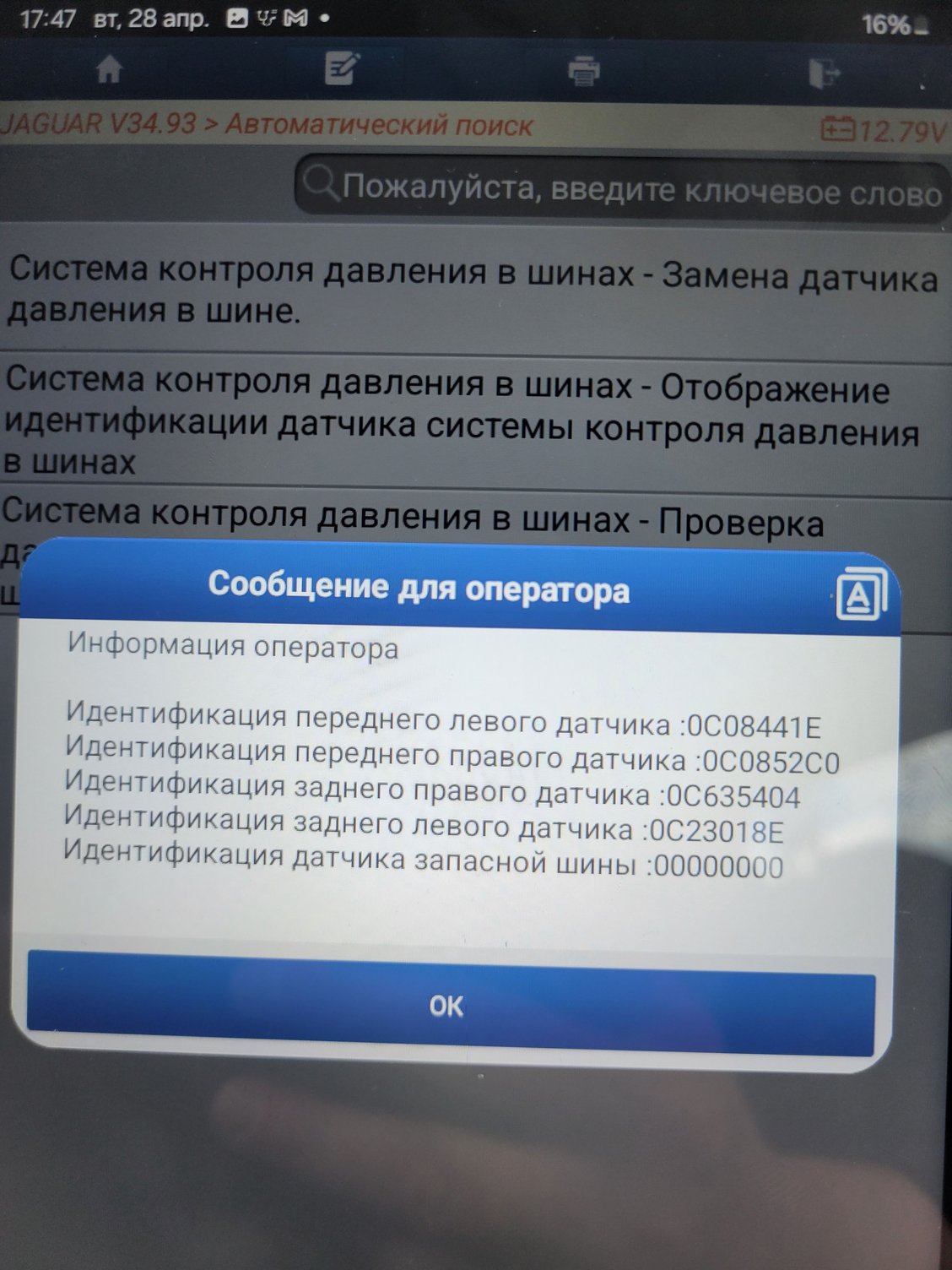

Hello, I bought a 2016 F-type and I cannot get rid of the TMPS sensor error. I went to a nearby tire shop, the diagnostician checked all the sensors, their frequency was 433 mHz, and each wheel was read correctly. After connecting the device that read the signal from the sensors to the car, an error appears and they cannot be programmed. My Vin number is: SAJWJ6BV9G8K22794, please tell me where I can look for a solution to the problem.
Should I buy sensors with a different frequency of 315 mHz?
I haven't had the car since new, I don't know what the correct ones should be, the car came with 433 mHz sensors, but they don't work, an error keeps popping up on the dashboard.
Thank you in advance for your help.
Hello, I installed 433 MHz high pressure sensors, the car sees them, reads the temperature, but still displays an error and does not provide the pressure. Can you tell me what this error means? What to do to finally make the sensors work :-)

I bought it from the link provided above, the sensors arrived, the tire repair shop installed them on the wheels and the problem still persists.
The sensors were read by the programmer and uploaded to the car.
Unfortunately, it did not help, it continued to display an error with TMPS sensors on the board.

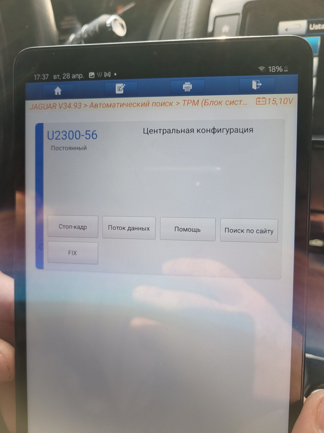

We connected the computer to the car and it turned out that there were two errors regarding the TMPS system.
Error codes:
C1D18-00
U2300-56
After resetting them by the computer, the car sees the sensors for a moment, displays their pressure on the car's clocks, but after a second it throws an error again.
In my opinion, the problem is not with the sensors but with these errors, can someone decode and write what they mean?
Thank you in advance for your help!

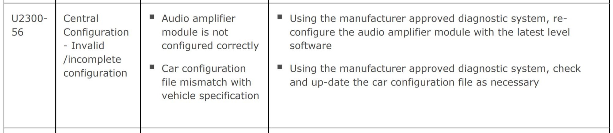

Both errors are listed in the Workshop Manual, which you can access here:
https://www.dropbox.com/scl/fi/o6d1x...=3v3nvhza&dl=0

The other error U2300 points to a CCF error and will require SDD to take a look. Here is a thread that talks about that error. He fixed it using SDD but no other details.
JLR Code U2300 Error
Can you get the car hooked up to a SDD setup? That would be the next step.
