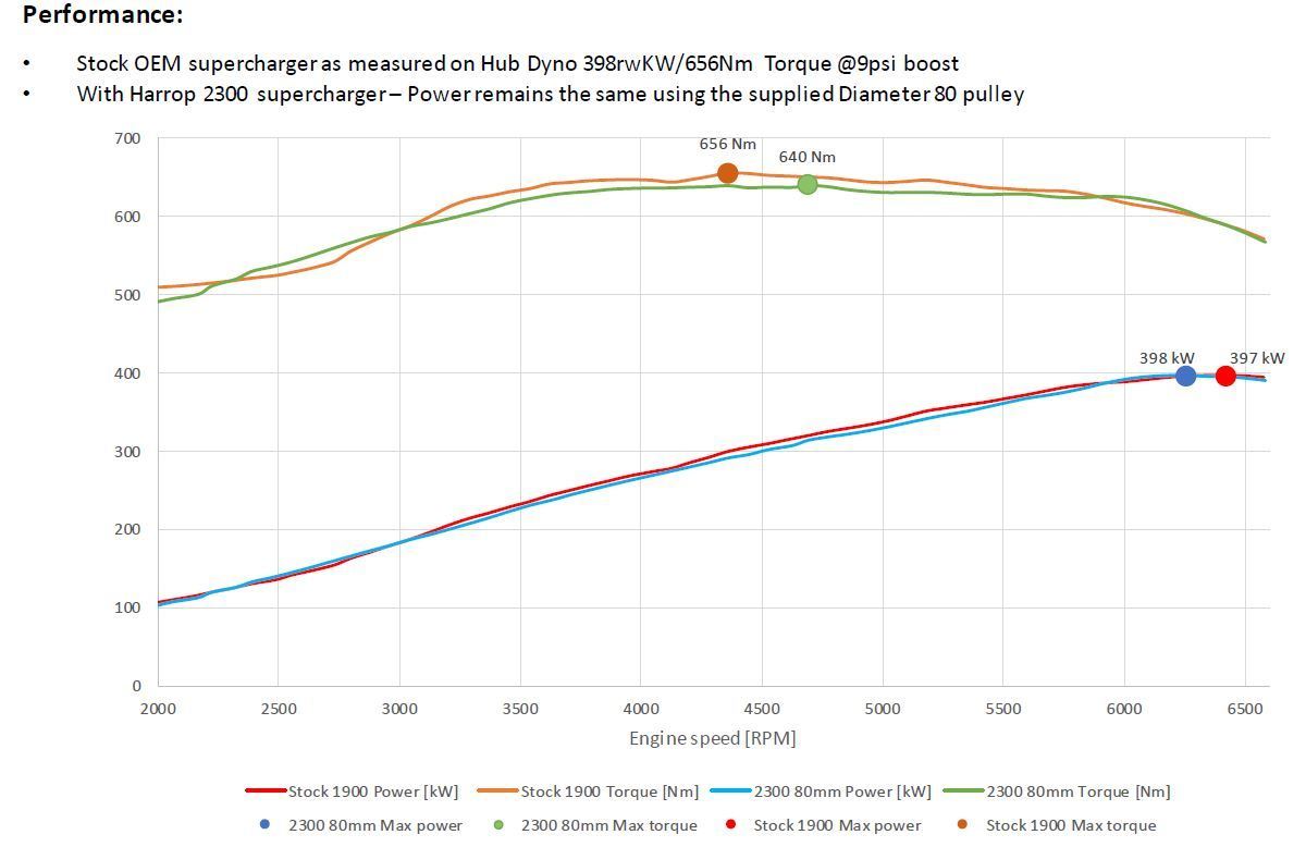

How much more horses?
None!!
But that's with the stock upper pulley and tune, obviously much more available with a smaller pulley and tune.
No mention of a larger crank pulley.
Go to the linked page then download the Tech Guide.
Note that the linked page is to Harrop AU but the same SC upgrade kit is available from Harrop USA for $5,700 USD, see here: https://www.harrop-usa.com/jlr-aj133...ercharger/p151

Originally Posted by Ricky5.0s/c
the stock blower is capable of 800+
Yes, but the 2300 will be able to generate that power for much longer periods without overheating the IAT.

OzXFR that's what puzzled me too?
The dyno plots don't show any improvement?
I expected to see some increase with stock pulley since the 2300 moves more air?
On the Oz site it says $4200 USD but then no mention of shipping and I guess it must be purchased from the US vendor?

I'd like to know if the 2300 is running the same psi boost as the 1900. I'd expect the 2300 to run less boost to make the same power as stock

This video answers my boost question. Harrop is running a larger pulley to keep the boost about the same as OEM

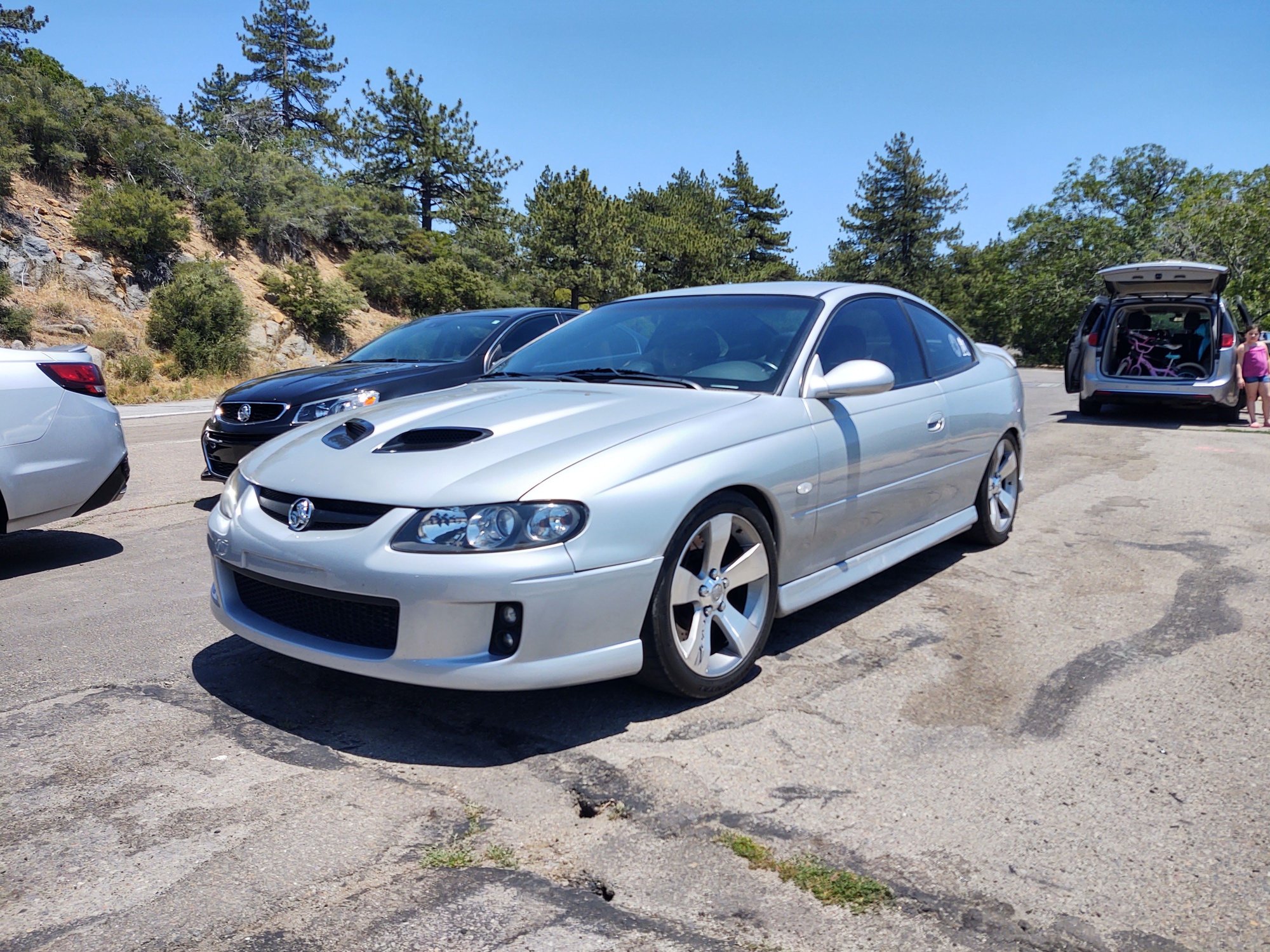

I am sorry I accidentally posted this pic by accident and I cannot figure out how to delete it.

Originally Posted by Ondatrack
Hmm, a Pontiac GTO.
Really a tizzied up Holden Monaro built in Oz with LHD then exported to North America.

Originally Posted by OzXFR
Hmm, a Pontiac GTO.
Pretty much sums it up. Then I added a couple of turbos and spent money trying to turn it back into the Holden Monaro, minus the RHD.
