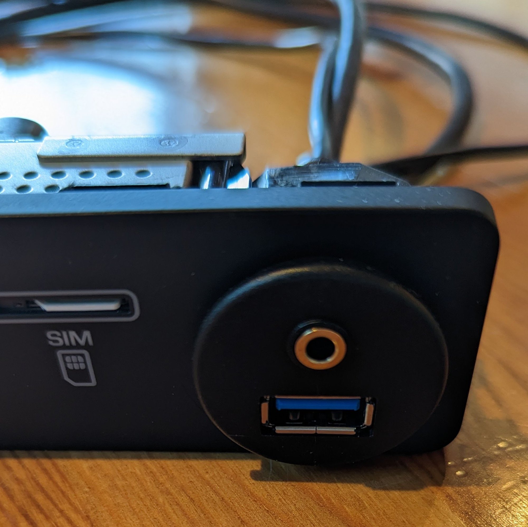

For anyone that might be interested I went with this solution in my MY18 to connect the AUX to USB & for the USB for wired Android Auto.

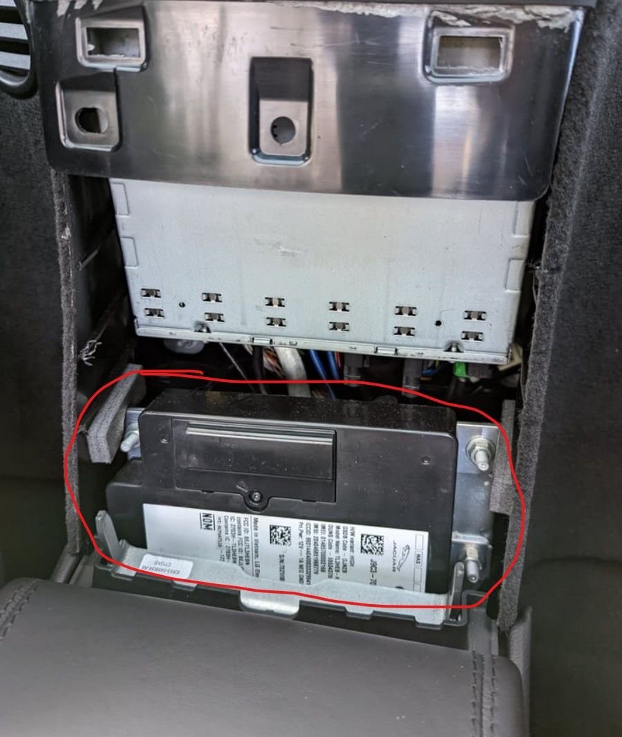

Reviving a really old thread... I'm about to install the UAD kit in my MY18 with the IMC system, looking exactly like in woohoo's initial post in this thread.
UAD only provide instructions for the installation in a vert which requires stripping out a lot of stuff in the back but don't show how to access the head unit in a coupé where you're supposed to be able to do it by just removing the cover between the seats. I can't see how to access the head unit power cable and remember seeing Blacks18 mentioning that it was tricky. How did you guys access the head unit to connect to power cable? Did you remove this black box and then somehow access the head unit, or did you have to remove more parts like in the vert?

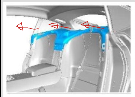

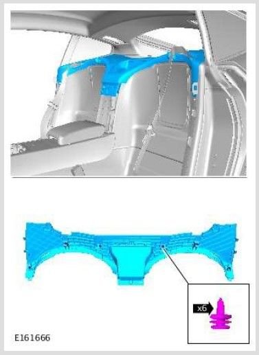

I ended up removing the trim behind the passenger seat with the speaker grill (pull it toward you); and in order to do that you have to loosen the long rear trim piece that goes along the top (push it toward the front of the car from inside the luggage area). It's easy enough to remove both pieces but be careful because the trim clips can be loose and might fall into the body work. It's a bit awkward working behind the seat too (move it as far forward and high as possible). It might be possible to make the connection without removing that trim but I found it far too tight for my big clumsy hands. Once the speaker grill trim is removed there is loads of access and it is connected in minutes.

Brilliant, much appreciated! So if I understand you right you:
1. Loosened (lifted?) the big plastic trim cover in the picture below
2. Removed the speaker grill on the passenger side (left hand side, since yours is a RHD car I presume)
3. Then you could pull away (or remove entirely?) the carpet trim behind the seat enough to be able to access the power connector of the head unit but didn't need to unscrew the head unit itself
Right?
  • Yes. Loosen = push it toward the front of the car from the luggage area (boot), it goes forward NOT UP (although not 100% necessary but it makes replacing the speaker grill MUCH easier because the grill tucks underneath)
  • Correct
3. Then could pull away (or remove entirely?) the carpet trim behind the seat enough to be able to access to power connector of the head unit but didn't need to unscrew the head unit itself
  • I was able to make enough room by pulling the carpet away. Head unit stayed in place, no need to unscrew or remove.
