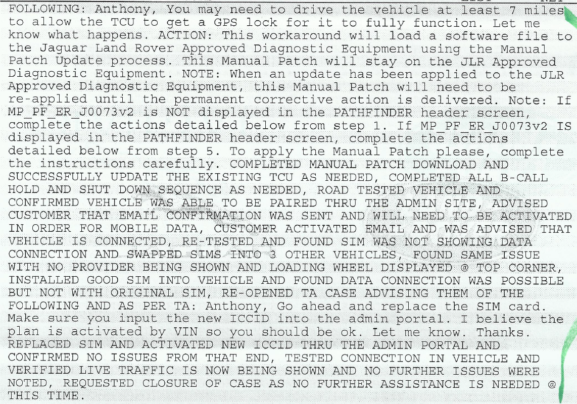

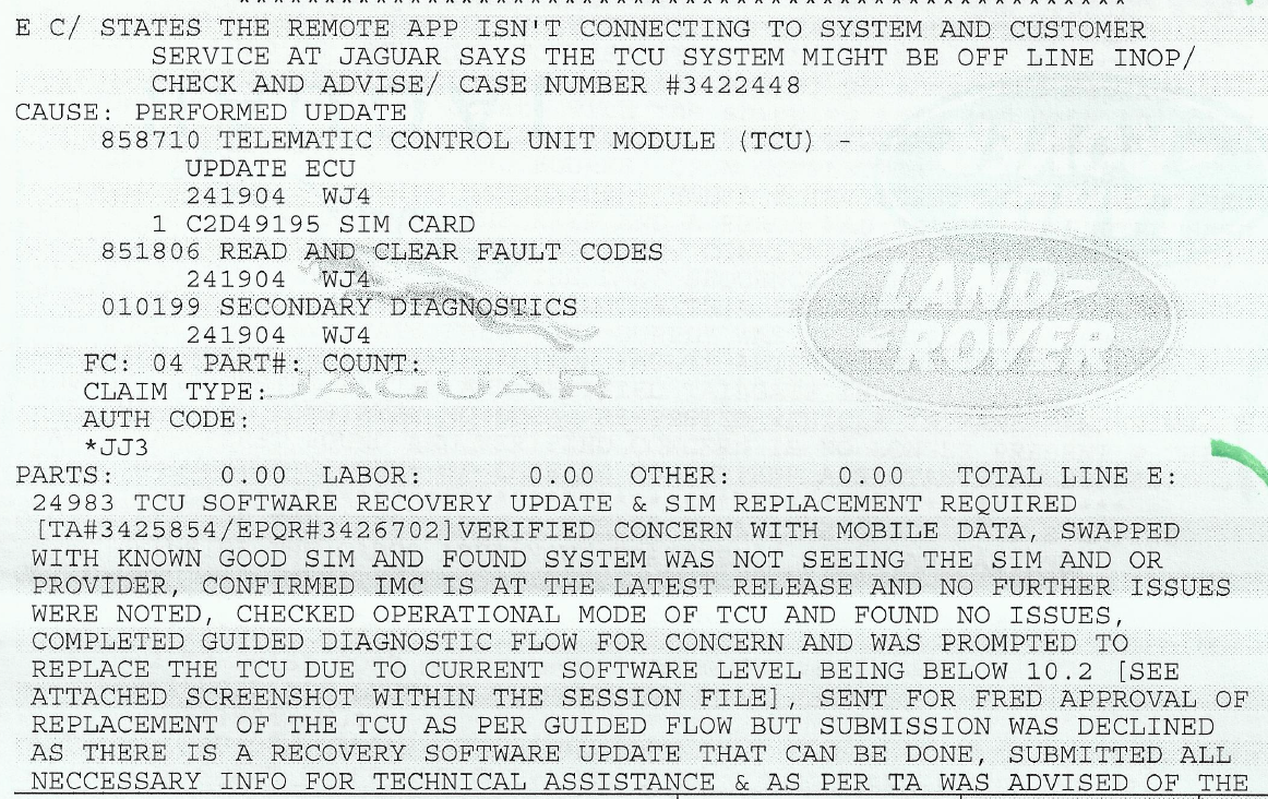

Quick update on mine... it looks like there is actually already a 4G modem in the MY2018, dealer went through a number of steps to resolve the TCU issue (seems like a firmware issue) and then replaced the SIM and now the car is connecting via 4G. Just to confirm - system is the old 8" ICTP system with buttons on the side (so no CarPlay):

Super interesting - that's exactly what I thought was going to happen to mine after what ViperX100 said above with having his TCU sent off, I was very surprised when they didn't seem to need to send it off at all. It was in for 3 weeks but that was for replacing the Body Control Module, Gateway Module and Tailgate Control Module for other issues (BCM was shorted). TCU issue was fixed about a day after I dropped it off. I do see the tech notes that it's a fix pending a "permanent fix", so I'm not too sure what's happening behind the scenes...
I kind of wonder if they changed the TCU hardware half way through the MY but I'd be SUPER surprised if they did that, I assume it's the same hardware. In which case it's maybe just the dealers inconsistently dealing with it...?

I wonder if the manual patch file mentioned by my tech came out after ViperX100 took his in? That and the "until the permanent corrective action is delivered" from JLR suggests a still-evolving situation to me. I wouldn't be surprised if they started getting a few TCUs in for replacement and figured there has to be a cheaper way to fix it that doesn't involve shipping all of the TCUs back... I'd hope they did!
I took mine in in early June and got it back in early July so unless they got a new patch since then, I wouldn't count on it. They had to ship the 3G unit to New Jersey to get updated.

Hmmmm, I would reference the work notes I pasted in above (post #24) where the dealership originally thought they'd have to replace the TCU in my 18 but then when they submitted a case for the TCU replacement, it was rejected noting that a manual patch was available that could be applied through a recovery software update which then (with a replacement SIM card, mine might have been faulty) allowed the existing TCU to work via 4G. Worked flawlessly ever since
