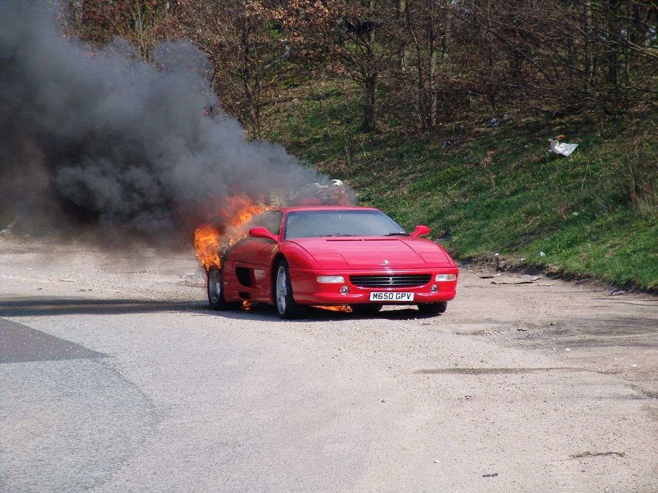

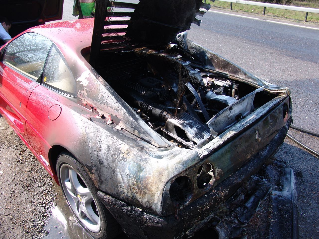

Originally Posted by awjens
I would ask everyone here who has tossed in a comment this simple question. How many cars have you had in your lifetime that started a fire while idling or even driving for that matter.
16 years ago. Ferrari F355. Caught fire while I was driving it on the highway (or motorway as we called them back in the UK). I have the photos to prove it.
