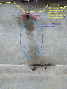

Old Apr 14, 2018 | 11:16 AM
  #64
ndabunka's Avatar
Joined: Oct 2016
Posts: 1,260
Likes: 157
From: Charlotte, North Carolina
see images for comments
Here is a link to the prior Exhaust and/or Rear Differential LEAK thread on here
https://www.jaguarforums.com/forum/f...d-leak-168670/

Originally Posted by Mikey;1876974
I[I
'm[/I] becoming more and more convinced that the Op's car didn't experience a fire or spit raw fuel out the tailpipes, just dripped some soot laden condensationin in his garage. Pretty much like all cars do.
This is exactly my conclusion - especially if it is his or his wife's practice to leave the car idling in the garage for some minutes (which is pretty much what he described in his initial rant. See #1 ) because the exhaust system fills with condensate - and if the car is not run long enough to burn that off (and often it does not clear through the tiny drain holes) then the next time the car is used a considerable amount of fluid leaves the exhaust pipe - sometimes it pours out under acceleration. I see this regularly in all sorts of cars used by what might be termed "less aggressive drivers".
The stains on the floor looks more like soot and water which is not unheard of on a cold engine.
Agree, looks just like my V8 does, mine never caught fire, don't think it's fuel.

Running at idle for 2 minutes, see the ground. It is just condensation from the tip and from the condensation that manages to travel from the tip's edge back towards the pipe (my car) added consideration... this was a V6, there is n crossover in the exhaust. If there was ONE bad injector, this would be ONLY on one side. The V8 has a crossover exhaust. The engine would NOT run well. And the gas expansion with that much fuel in the pipe would be massive. The system would default to quiet mode (full muffler), to have so much fuel to come out of the tailpipe would just be unthinkable. Lastly, yes the I4 has a fuel rail issue (poor brazing), that causes leak in the engine compartment, at best it would come out from the belly pan cover.
