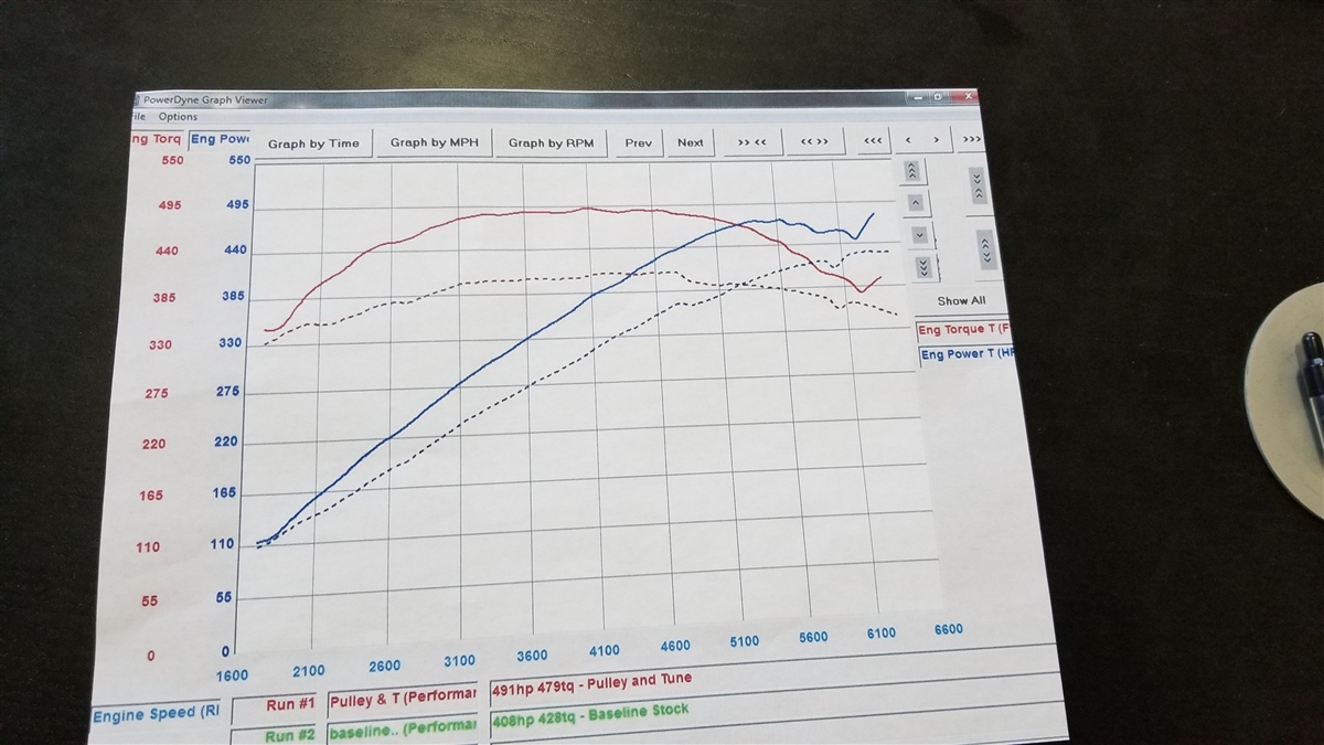

Originally Posted by supersportmtl
Mr. Stuart, I appreciate the excellent answer to my question!
Here is the dyno graph from your website for the pulley and tune. What is happening between 5500 rpm and redline with the torque curve?
Thank you!
Sorry I thought this was your own generated graph - Chris told me it is a customer supplied dyno graph on our site. We don't have any logs for this car as it was independently customer produced. The torque curve looks pretty close to how it should, normally it would start to tail off at 5250 where torque should peak. It's possible that the dyno operator didn't fix the RPM's spot on (some dynos set RPM by having the operator hit a button to lock in RPM at 2000, you can be off by a little bit.)
There's one small dip up top which could be quite a few things, most often what we see is inadequate airflow cooling on dynos. For example, we had a customer once who was testing our tune on his FType R, both before & after. He was actually disappointed that it didn't make more power, but when we were able to get further data (in this case it was just AFR) we could see that the AFR was plunging to 9.5:1 on not only the 'After' run but the 'Before' also. When we got pictures of the dyno setup there was one tiny little carpet dryer fan in front of the engine. Car was getting hot and dumping fuel. So it could be a few things, could be old fuel, who knows.
But inconsistencies and unknowns like those are the reason we brought in another test vehicle to do some re-verification of our own and produce some bulletproof data, which is what we've supplied above, and what is being populated to the website.

Originally Posted by stuart@velocityap
sorry i thought this was your own generated graph - chris told me it is a customer supplied dyno graph on our site. We don't have any logs for this car as it was independently customer produced. The torque curve looks pretty close to how it should, normally it would start to tail off at 5250 where torque should peak. It's possible that the dyno operator didn't fix the rpm's spot on (some dynos set rpm by having the operator hit a button to lock in rpm at 2000, you can be off by a little bit.)
there's one small dip up top which could be quite a few things, most often what we see is inadequate airflow cooling on dynos. For example, we had a customer once who was testing our tune on his ftype r, both before & after. He was actually disappointed that it didn't make more power, but when we were able to get further data (in this case it was just afr) we could see that the afr was plunging to 9.5:1 on not only the 'after' run but the 'before' also. When we got pictures of the dyno setup there was one tiny little carpet dryer fan in front of the engine. Car was getting hot and dumping fuel. So it could be a few things, could be old fuel, who knows.
excellent thank you!
