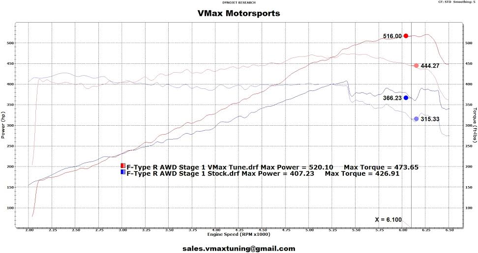

Met a local forum member at the dyno today and netted some very solid ECU tune only gains.
Stock: 407awhp/427awtq STD.
VMax Tuned: 520awhp/474awtq STD.
Gains of 113awhp/57awtq on 91 octane pump gas.
We expect another ~30awhp/25-30awtq when our +1.8psi pulley goes on.
This is the same ECU tuning that's presently on sale for $1000 + shipping. Please contact us at sales.vmaxtuning@gmail.com or call us directly at 949.264.3072.

I'll get this question in before everyone else jumps on it.
What happened with the before run where it falls into a mess from ~5350rpm?

+1. If you extrapolate the stock curve, the peak would have come real close to the expected stock number of 467hp (0.85x550). I would suggest your actual gain was closer to 53 horses. Still would be interesting to find out what caused the indicated power disruption on the stock tune..
Even so, still an impressive output.

Same... There's no way you can use that before dyno to support your claim of +113whp. There's clearly a problem and your tune did not have that much of an increase. Aside from the fact that would mean 26% drive-train loss, it doesn't make sense to see a torque increase of less than half of the horsepower increase on these motors. A 60whp gain sounds more reasonable.

Honestly we have no idea. First this is the lowest reading stock 2016 F Type R we've seen. Second the loss in power with the stock programming is indicative of heat soak, however, we did not see the dip in any of the tuned pulls. Every stock pull showed the same loss in HP/TQ in the same area.
The customer (also a forum member) can back these statements as he watched the progression on the dyno today.

We have seen non peak to peak gains of 110awhp+ and peak to peak over ~80awhp already on cars with linear stock curves. I'm not sure where you're getting 60awhp, but it's certainly not from our posted results.
Fact 1) Problem or not the car with stock file couldn't make over 400awhp and consistently showed the same loss in HP/TQ--would you rather we lied to you and painted lines in with MS Paint?
Fact 2) With our ECU tuning the same car made 520awhp and never showed a power reduction issue.
Fact 3) This was witnessed by the owner of the vehicle, and as far as tuning goes, it's not his first rodeo either.
edit: The stock pull used was actually the highest HP and TQ pull made with the OEM calibration.

Let's not get carried away gents.
I was not knocking the result post tune (it speaks for itself, impressive!) i was more concerned about what was going on with the stock tune, because that's not normal.
If the power was dropping off like that on the street all the time then I bet the owner is all smiles now that the tune is in!
If it hadn't dropped off in the top end I would have expected maybe 450awhp at the most, so that would still be a ~60awhp gain, which is still very good.

And i'm not saying the tune isn't good, or a large improvement. But you can't be giving out unreal expectations of 100+ gains with false data. People will think they will get this too (as you've advertised) and then be pissed when they only see 60.

He's simply posting the data they recorded. Clearly there's something weird going on with the stock curves at the top end as was acknowledged. However, that doesn't change the fact that there were significant gains across the board.

Nail on head Sir.
As much as anyone wants to extrapolate the stock curve to eliminate the real life dip in power everyone witnessed over multiple pulls, you are simply interjecting biased/subjective data where there was none prior.
Also extrapolating from midrange rpm on positive displacement blown engines will lead to erroneous data as the change in delta is not linear at redline.

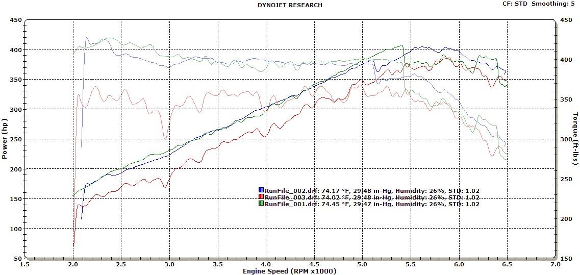

All three stock runs attached. Note that we used the stock pull with the highest peak HP and TQ for the before/after tune comparison.
edit: Results from a Super-Flow AWD linked dyno on 93 octane (2016 F Type R) coming tomorrow, another forum member. Just a heads up, if this dyno is like other Super-Flows it will read moderately lower than a DJ. Like an old school Mustang Dyno before they had the ability to correct on par with a Dyno Jet. That means before and after gains will be smaller than with a DynoJet Dyno so be prepared!

You can't jump to a conclusion that there is an "issue" with the car. The issue may very well be you and your inability to feel the power loss at higher RPM. Speaking for myself, I felt the car was very loud but slow stock, especially at the higher RPM range (5 < x < 6.5). After I received the tune from Vmax, the car had more power, not only where I wanted it but the lower end as well. As mentioned elsewhere, the car became fun to drive again.
A 25% power loss is very reasonable and realistic, considering the layout of the vehicle. Also, this is Jag's first year making the R as an AWD, who knows how inefficient and clunky it is. You shouldn't default to assuming VMax is trying to trick or defraud because they posted a dyno sheet. I can relate to what was said regarding individuals who will never be pleased. Having worked with many clients and vendors over the years, some people can never admit or be seen satisfied, say 'you're right' or 'I was wrong.'

Ok I have no stick in here, but have looked at multiple dyno results to also better understand my own results, and just want to share my thoughts.
Assuming drivetrain losses isn’t a good idea, as that is per dyno type already different. These differences are already caused by tire losses and different ways of strapping down the car on different sizes of drums and other sorts of different ways in measuring as well. Next to that I do not believe the drivetrain is automatically of a bad design just because Jaguar uses this for the 1st time in the Ftype R. I would give them more credit here.
Last but not least, as the awd works in such a way that all power can be directed to the rear wheels at higher speeds/full power (via an electronic clutch if I read the papers well), the actual drive train losses will be closer to a normal rwd car again (not the same as a small portion still gets lost in extra inertia of the front rotating parts).
Considering the stock dyno, there was indeed something wrong there, without a single doubt, so yes you can compare the figures and take that as a factual figure, though not something I would use personally.
Assuming the 1st part of the curve is about right, then an estimated line to 6000 rpm would be closer to 440 hp, which incidentally is in line with jamesjaguar results (stock result and ecu tune even)
