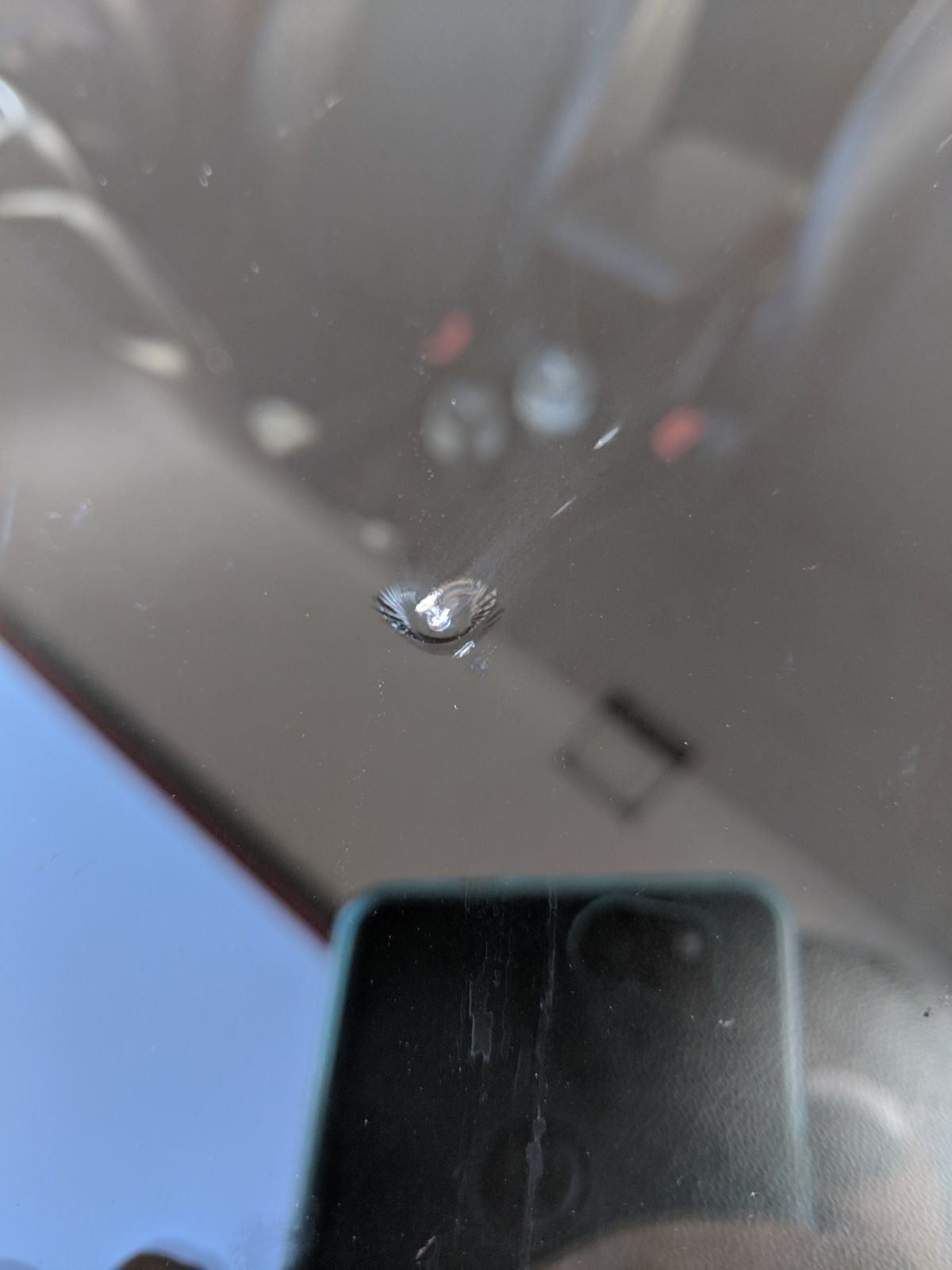

So I finally ended up taking some pictures of the windshield pit (see link below)... and when looking at it I actually discovered a few other tiny pits on the windshield which are less noticeable, and even one at the front end of the sunroof. The 1st and the 3rd picture are of the stone pit in question. The 2nd photo is of another pit lower in the windshield. In the 3rd photo you can see how superficial it is (the 2nd reflection is the middle windshield layer, and the 3rd reflection is the back side of the windshield).
Anyone else got these little pits on their windshield? Any success with touching it up and making it less visible? I'm not sure if the Rain-X or Permadex DIY kits would work on something this small or if I should bring it into a glass repair shop to have it looked at. Or perhaps I should just accept it and leave it alone. This is from a crazy person that eventually accepted the speck of dust on his watch dial after a month or so
https://imgur.com/a/dYic66G

  • as you mull this over, quickly place a tiny dab of clear fingernail polish on the culprit.. That will allow you the time to engineer this situation into oblivion...and gl Sir

I have a repair kit that works pretty well. I tried a couple but one very close to what the pros have used when I had them do the job. I think it's the Rain-X kit, but will need to pull out the detailing box to be sure. This picture looks like surface pitting only, but look for small cracks that might appear after a couple of days. I think I've used it on chips like that. It's a resin that cures in UV light, and the doohickey (sorry for the technical term) that forces the resin into cracks wouldn't be needed for that. A drop of resin, put on the clear plastic film, and let sit in the sun for 15-20 minutes. Peel the file and shave the resin flat with a single-edge razor blade.

It doesnt look bad enough to result in a crack from thermal creep but being right in your sight line if you are like me your eyes will focus on it which is very distracting and potentially dangerous. Given where it is and the risk of making it worse I wouldnt stuff around with it yourself, I'd go to a windscreen joint and they could deal with it.

Two windshields a year! Hot damn, at least it's not the F-Type... with the heating elements it wouldn't be cheap.
Going to show some pictures of the scratch to a few local glass repair places and see if they can do anything about it.
