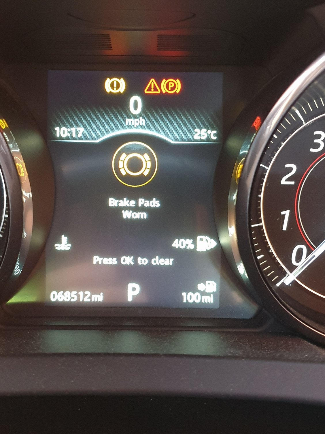

If you are going fast when warning trips:

Jaguar remote incontrol app will indicate the following status message:
The information panel will display
