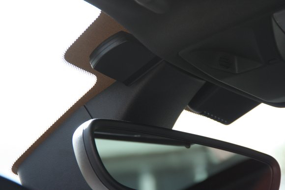

Yes. From 2017 onwards it has solar attenuating glass that seems to block some toll transponders, radar systems etc. but there is a patch up to the left and right of the rear view mirror which is covered in a black film and doesn't have the solar layer. On mine there is a temp / humidity sensor in a black casing on the right so I mounted it to the left. Here's a similar photo I found online
I have the standard MA EZ pass transponder in mine in that same place and it works every time
Note - can of black spray paint and 5 mins of work before you install it makes it invisible!
