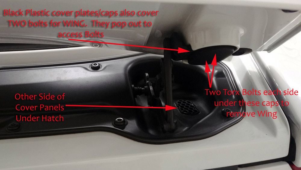

I have not/had not experienced this (and now have a fixed wing)., but based on your description, the first thing I would check is to be sure the wing (panel) is securely attached to the base? There are 4 Torx bolts that hold it in place. I have a few pictures and info in my DIY that may help...HERE.
It could also be the rear lid latch being loose....When the wing deploys and adds more pressure, it could cause it to resonate and rattle?
