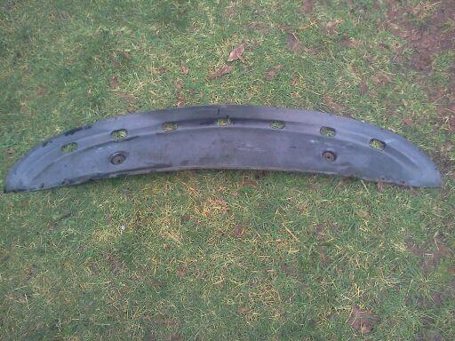

Is this the part I need to support the front spoiler on my 86 XJS

Old Feb 7, 2016 | 08:29 PM

That's it. Thanks for your help

FYI, It fixes to the cross member under the rad (by those indented holes halfway towards the back edge as well as to the spoiler leading bottom edge, and also to the bottom of the wheelarch baffles in front of the front wheels. Do all this and together with the spoiler it will make quite a rigid structure and last a long time.

I found that water stayed on the tray and was rusting the cross member so after derusting and painting it, l put a small SS washer between it and the tray to let the water run out. I also made the two angle brackets on the sides out of SS and used plastic nut and bolts (UK number plate bolts) to fix them.

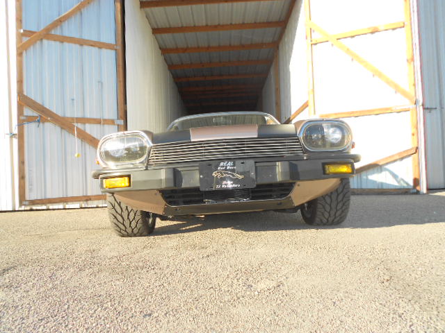

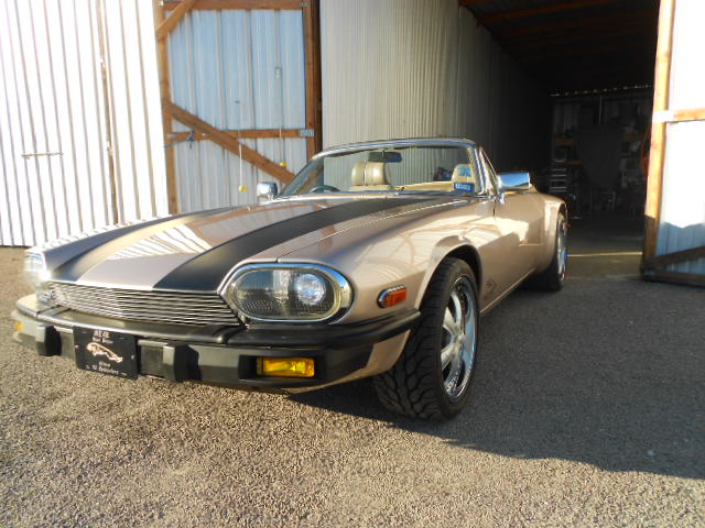

i like the no spoiler look,, have been up to 130MPH with no lift, i agree it could get light if you went faster(i rarely do).
i like the stance from the front view, shows the lower fender angles and wide tires, (Agressive look).
BUT to each his own.
That's what I thought as my car did not have it when I bought it. Once fitted though, the change was enormous.
greg

Great idea for the cross member. I did just what you did for the wheelarch fixing. Works a treat doesn't it?
IIRC, the spoiler wasn't just for downforce, but also directing air for cooling purposes.
I believe a car without a spoiler will run hotter.
had it that way for 22yrs , in Florida heat and now in Texas heat ,ambient sometimes into the 100F, no overheat probs! i use a permanent digital readout temp gage,along with the factory gage.
altho i had a Mazda RX7 and if you run without the front under car shields it would overheat, something about air flow stagnating and slowing outflow of air behind the radiator!
if i ever need a front spoiler i would make one far more effective than the factory rubber one!
