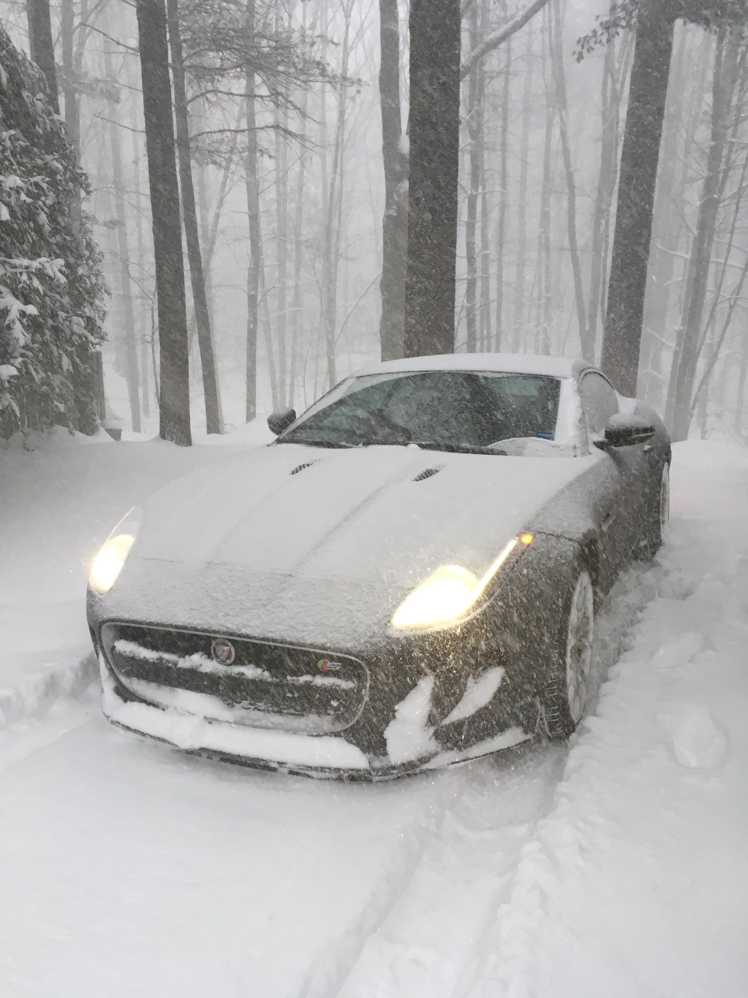

Kindly do NOT rush winter! Having said that, you do know this will be the third winter I have my car and not once did I NOT drive it due to crappy winter/wintery conditions?
I swapped out my OEM's to Continental Ultra-High Performance ExtremeContact DWS06's and haven't looked back. In other words I love them so much that I don't even bother swapping back into any summer tire. Of course, they don't have the grip that any, or most, summer tire would have but I don't push it so much that I feel I'm lacking in any grip given I don't push the car beyond its or my limits. (You might disagree when you see my driving in just over two weeks; fortunately I do not have a sticker which reads: How's My Driving?).
Speaking of which, and I am not a paid spokesperson for them, you do know Continental is paying for the T-Shirt you'll soon be wearing (and, no, I'm not suggesting that that's a reason to buy their tires)?
