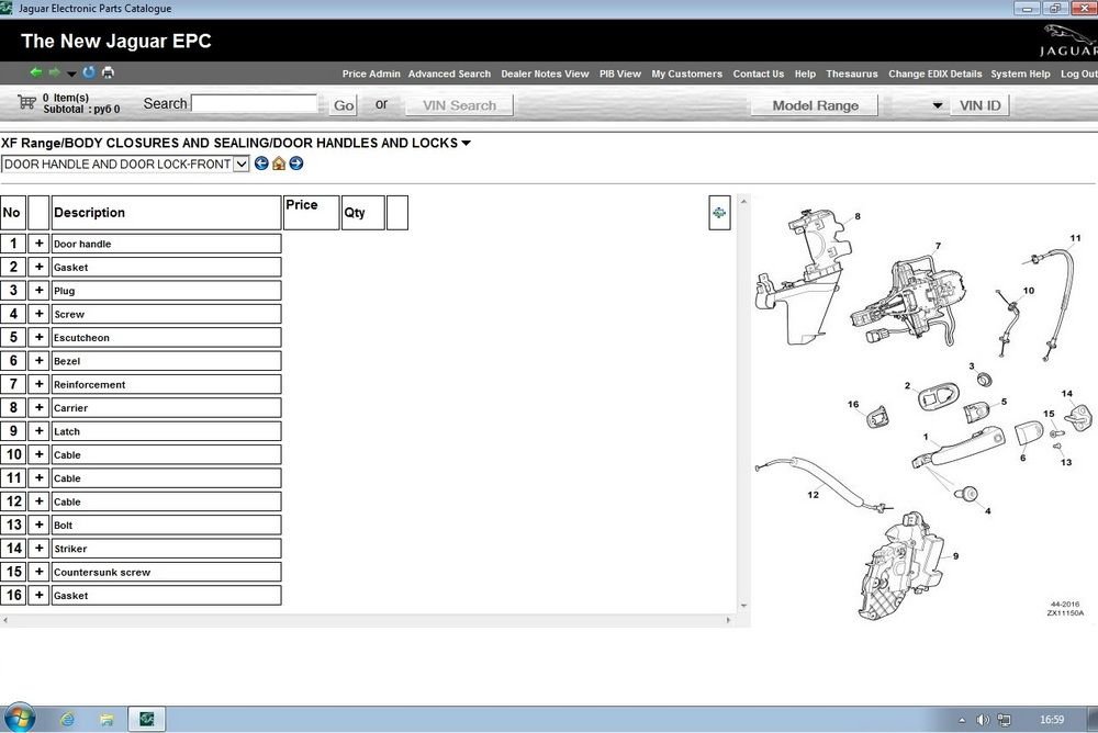

Welcome to the forums Samdalo,
The door latch is an electromechanical device where cables link to the interior and exterior handles. This section from the XF Parts Catalogue looks very similar to my XK:
Item 12 operates the interior door handle. I suspect you may have an issue with either item 10 or item 11. The only way to find out is to remove the door card. If you need advice on this, the X250 model forum is the place to post the question.
