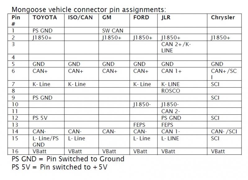

While the Drew Tech Mongoose JLR isn't chump change, it's a *lot* better than the cost of a VCM. It gets to be competitive with the AutoEnginuity which apparently cannot program modules even with the Jaguar extensions.
Did Drew happen to explain the difference between the JLR and their more generic Mongoose?

They are different because of the many variations among manufactures for module programming. If the J1962 connector was for OBDII alone, they would all be the same. The connector has some pins unassigned by the SAE standard, and the manufacturer can use them as they see fit. The Mongoose line of interfaces are intended to be used with the manufacturer software, consequently there has to be some variations in the interfaces. Attached is a nice chart showing the different Mongoose pinouts. As you can see, the JLR is the busiest of the bunch!
Hope that helps!
