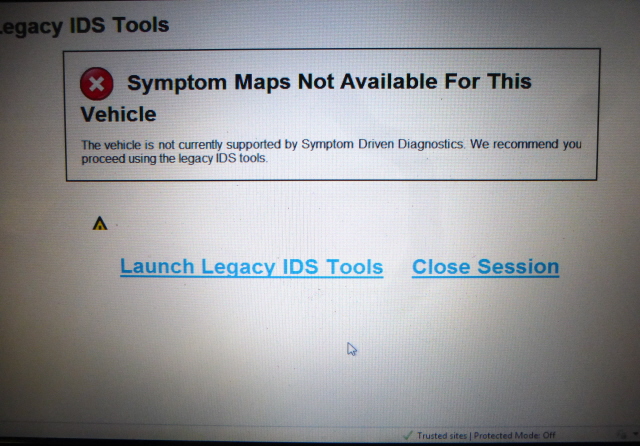

Then I go to my 2004 S-Type, hook it up and read the VIN, and as expected I get the message to start IDS,I press the icon and it tries to start IDS but then just returns to the previous screen.
Anyone have any words of wisdom?

After entering the VIN manually the system tells me that "This vehicle is not supported by the SDD.Nous recommend proceeding via conventional IDS tools"
2 options are available: Start conventional IDS tools or Log Off.

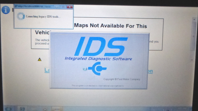

If I choose the first option, the homepage IDS tools appears and the screen clears and .... nothing.

You need V130 if you want IDS.

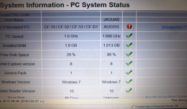

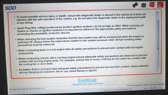

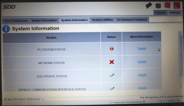

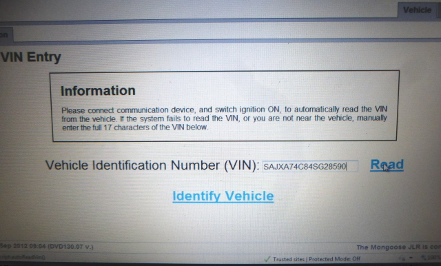

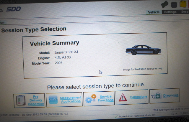

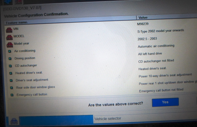

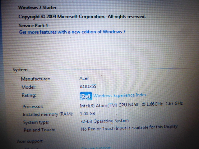

I have attached some screens from my Windows 7 SSD install with my 2004 S-Type and 2004 Vanden Plas.
Attached Thumbnails Cloned dealer scan tool-computer-spec.jpg   Cloned dealer scan tool-ssd-opening-screen.jpg   Cloned dealer scan tool-systen-information-screen.jpg   Cloned dealer scan tool-system-status.jpg   Cloned dealer scan tool-my-2004-s-type.jpg
Cloned dealer scan tool-transfer-ids.jpg   Cloned dealer scan tool-proceeding-ids.jpg   Cloned dealer scan tool-vehicle-id-ids.jpg   Cloned dealer scan tool-identifying-my-2004-vanden-plas.jpg   Cloned dealer scan tool-2004-vanden-plas-id-2.jpg
