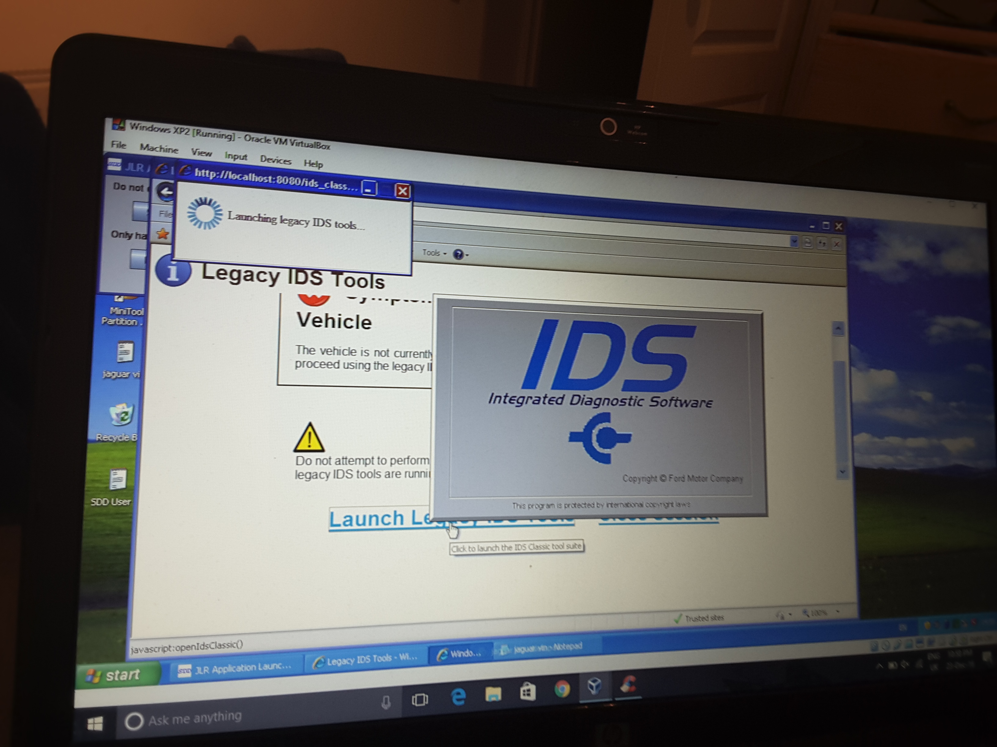

I hope someone can help. I am reading through this thread.
I have a VM running XP pro 3. SDD loaded.
If I input a post 2005 it asks me to turn on ignition, as expected.
If I input a 2003 vin it asks if I want to launch legacy IDS. I say yes, I then get a small window and a ids screen, these both then disappear. And I'm left with the SDD screen.
Basically do I need to be connected to the car to launch IDS or should it launch then ask for a vehicle connection.
I'd like to make sure my system is correct while I'm waiting on my cable, any help greatly received.
Thanks

The answer is NO. It should launch, but it may take 15-25 secs before the page appears.
