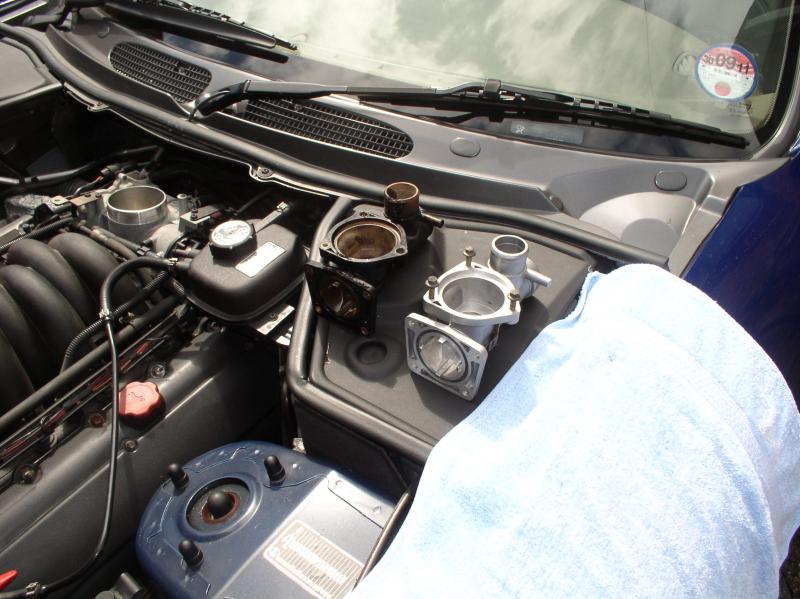

The Thermostat Tower is a known issue on the V8's.
The OE Jaguar plastic Tower can crack leading to coolant loss. A regular upgrade is to replace this with an aftermarket aluminium Tower. This is the original (left) and replacement (right) on my 2001 XK8 but I had to do the same change on my previous 2001 XJ8L:
Does it appear to be anything more serious than a leak from the cap?
Attached Thumbnails Coolant issue-10-original-replacment-thermostat-housings.jpg

At 1st glance it appears to be from the cap itself. The coolant is coming up through that hexagon centre. We just dried it out and I'm going to run it around the block and get it hot and look at it again to be sure.
Would I need to replace the entire housing as I see in your picture or just the cap? And where would be the ideal place to order that from? And also, what would I be asking for exactly?

You'll be lucky to get away with only a cap and seal leaking. However, if this proves to be the case, these parts are available separately both from Jaguar and aftermarket suppliers.
The odds are the Thermostat Tower will need replacing and, if so, it's prudent to swap the Thermostat at the same time as these are also a regular fail on the V8.
As you can see from my location, I'm a long way from Georgia! Any advice I can give on parts sources won't help.
Now you've discovered exactly what the issue is and what's required to fix it, a question posted on X308 section asking for US suppliers is the best option.
